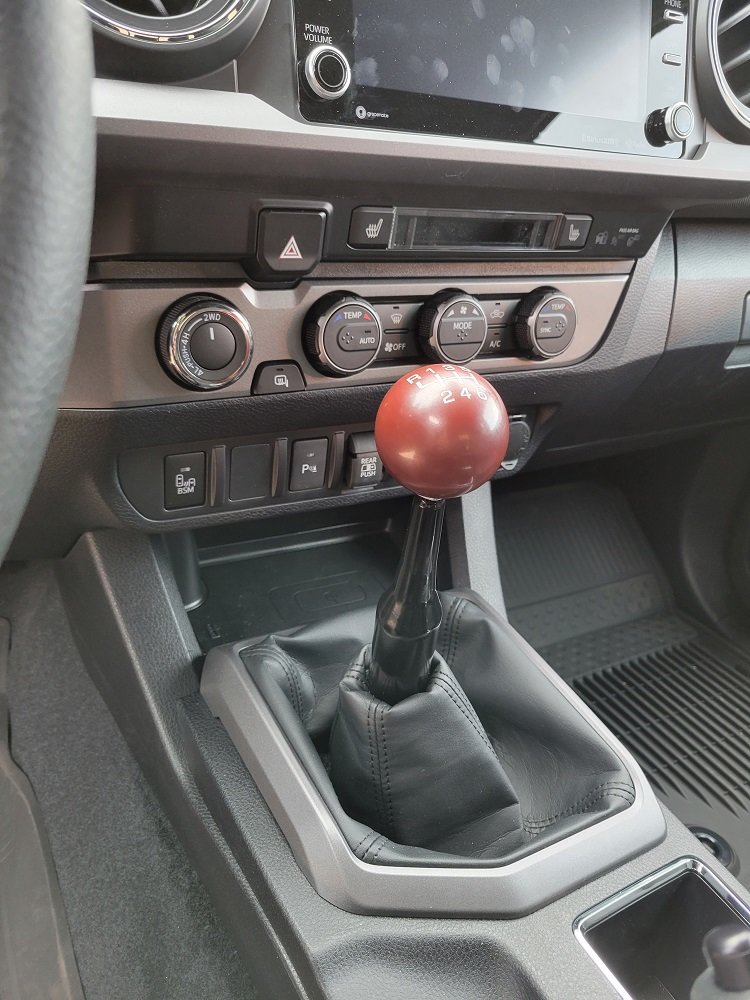

    Well... there is the Core shifter option or the URD shifter option. I took the URD option... the Core wasn't available at the time...
    This is the factory shifter with the URD short shifter and a TRD shift ball.
    Or the Core : https://core-shifters.com/products/...tick-for-toyota-tacoma-2016-2019-v6-4x4-rc62f
    There is also a great thread called Show me your knob here if you search it up. Lots of peoples knobs to gaze upon!

    when you take the stock boot off itll expose the rubber boot underneath. it doesnt look exactly like that but similar. i believe its used to cut down on transmission and road noise. i forget exactly, but when i installed my core short shifter i think i left out that boot cause i didnt like the look too much. now i have an audible mechanical sound from the transmission. i dont mind it much cause i like the sound tbh and its pretty subtle where you only hear it when the stereo is off.

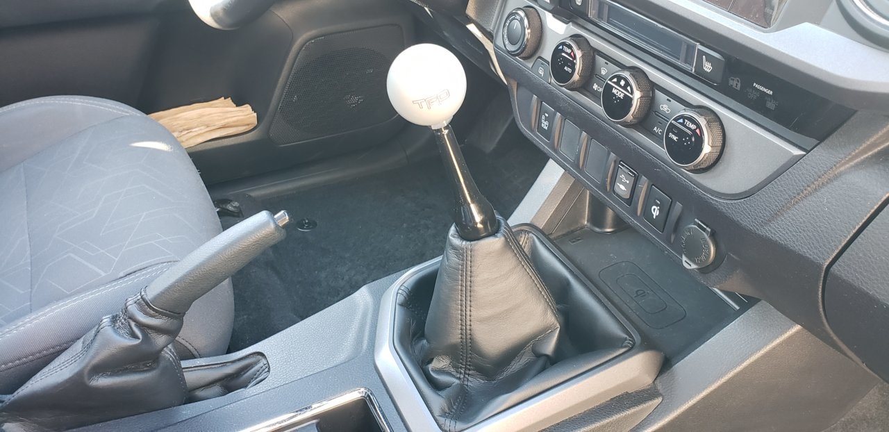

    I love what you did with the shift boot there, how did you get it like that? I recently upgraded to a 3rd gen and I have the TRD shift on mine too but there's this stupid fake chrome plastic thing that clacks on the lever every time I shift.
    Any advice would be much appreciated, thanks man!

    When you remove the shifter boot, turn it inside out. The chrome ring is zip tied to the underside of the boot. I snipped the zip tie and removed the ring. Then, I zip tied the top of the boot to the shaft before I reinstalled the base.
