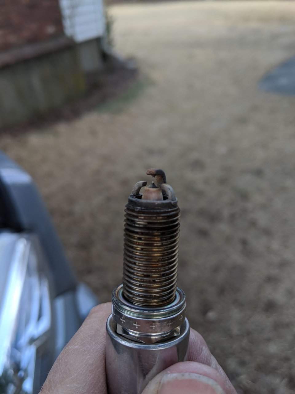

    Finally got around to changing my plugs for the first time today after 90k miles. Three of the plugs were just finger tight, and one of them was at least a turn and a half loose. As you can see in the pic, the coil took a beating. I can't believe the plug didn't shoot out of the head.
    The bad one was from cylinder #2. The other coil was from #4 as a reference.
    Not sure if this is a common occurrence, but I really recommend check at least the easy to reach plugs for tightness as these could show if a general problem exists.

    Looks bad. Maybe the spark plug seal on the valve cover gasket leaking.

    IMG_20200224_170922.jpg The only good thing for those of you checking is that the really loose plugs were the easy ones on the passenger side. The buried ones on the driver's side we're pretty tight. The plug manufacturer recommends finger tight plus another quarter to half a turn if your checking. All the plugs looked pretty good with the worst one being the loose one. This is the plug from #4 which was moderately tight.

    I checked my plugs last week. Thankfully, all were tight and good. Although, those dry threads made me cringe. I used some antiseize.

    Not so sure if qc. I had a 4.7 tundra and replaced the spark plugs every 30k miles as said in the manual. Every time found one or two loose even though i torqued them down to spec.
    Asked one of the mechs. at my buddies garage...said the same, they suspect some minor detonation at times causes it.
