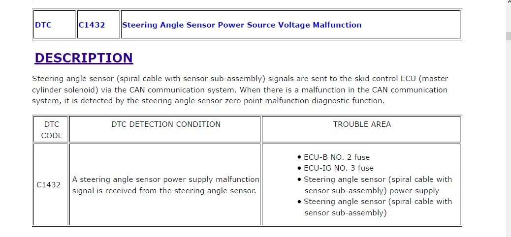

    It has a code of that matters...C1432.

    Assuming you’re using Techstream why can’t you post the plain english description of the code you’re getting? I’m sure that obviates any problem you’re having...

    Have you done the VSC calibration? OP's might be pooched because he was fishing wires...
    ECU-IG No. 3, 7.5A, driver's side junction box
    ECU-B No. 2, 10A, engine bay junction box
