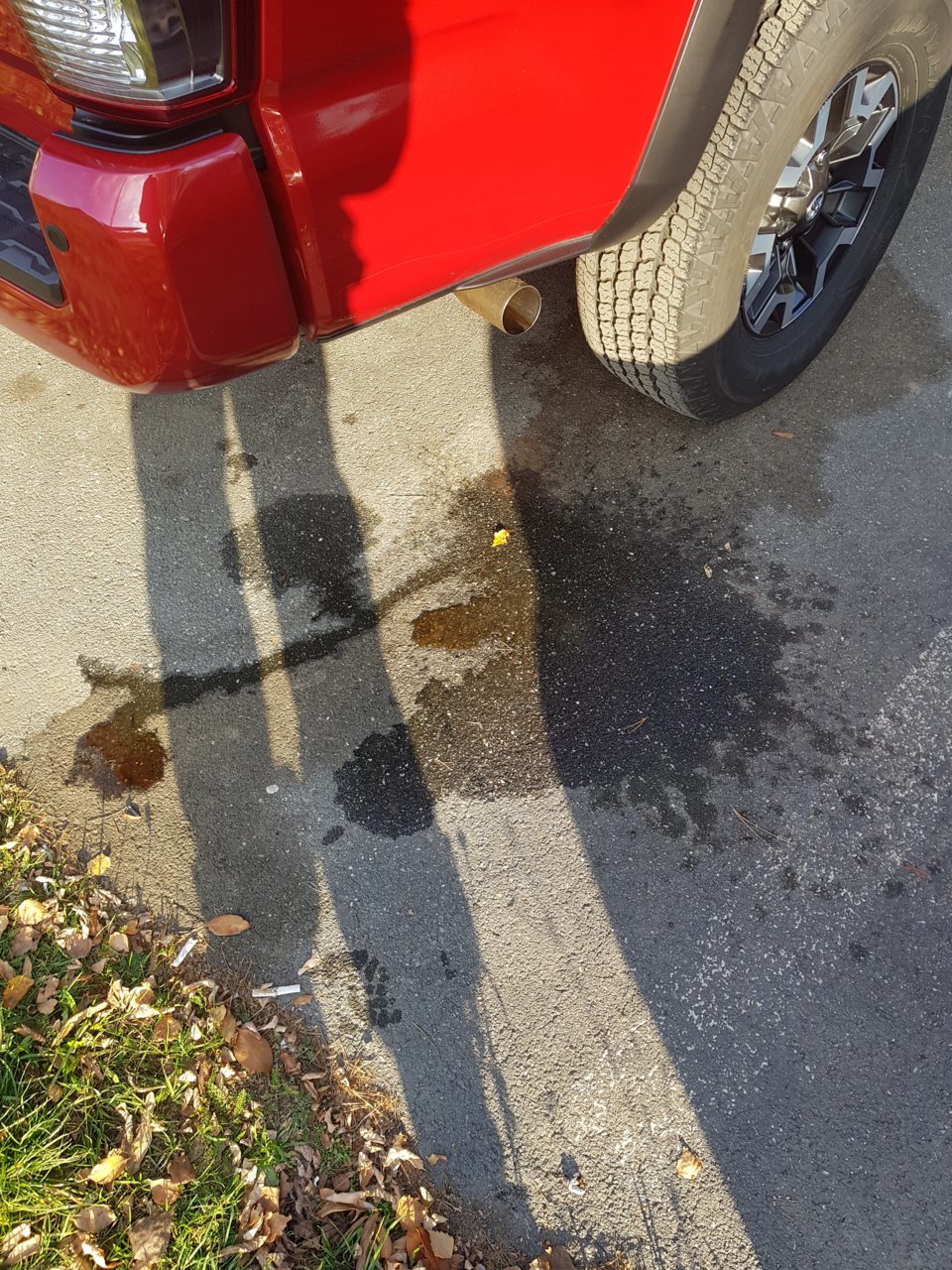

    Hello all. I've had my Tacoma about 2.5 years now and it has never given me any issues here in Germany. Today as I was getting ready to ship it back to the states it decided to give me trouble. The "Check Engine" and "Trac Off" lights came on, and the engine began to erratically lose power. When idling it would constantly drop to 500 RPM and reach back up to idling speed and go back and forth on it's own. When depressing the accelerator pedal, it could not reach anything higher than 2200 - 2300 RPM. It could barely even make it through the parking lot. This came as a surprise to me since I had cranked it up maybe 2 to 3 hours prior and ran it for roughly 30 minutes to de-ice the windshield and burn off enough fuel to be able to ship it (they require the gas tank to be no more than 1/4 full) and it ran perfectly fine. I've made sure that the gas cap was tightened down, and tried disconnecting the battery several times for up to 10 minutes and the issue came back every time. I checked as many connections as I could find in the engine bay to ensure everything was snug. I believe this may have been caused by water damaging something while I was cleaning the engine off the day prior, but it ran fine yesterday after washing and first thing this morning.
    One of the employees mentioned that it could be caused by an excess of water accumulating in the muffler after he saw a large amount of water come out of the exhaust pipe while revving the engine, and there was actually a large pool of water collected around that area which made his assumption seem plausible. I also checked the air intake filter and found it completely dry. I'm leaning more towards an electrical or sensor issue. Has anyone encountered or experienced an issue such as this before? Any assistance provided would be greatly appreciated. Thanks in advance.
