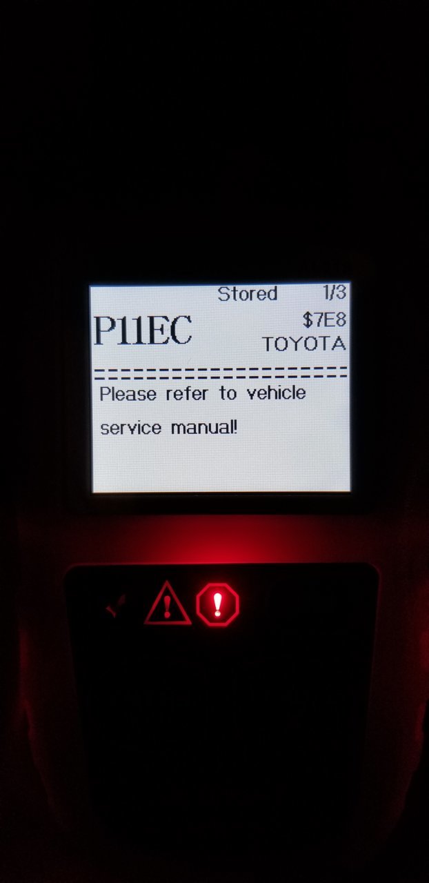

    2018 Tacoma with 46,000 miles. On the way to work yesterday the check engine light came on while idling at a stop light. I used a code reader today and received a Toyota specif code of P11EC.
    Only found one thread that mentioned this code, but no resolution. Any idea on what I am looking at?
    I'll bring it in to Toyota, but don't want a run around from them.
    Thanks,
    Dave

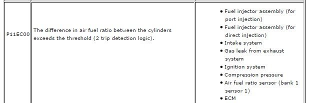

    Thread was, tacoma 2017 misfire

    Looks like you have 3 codes stored, what are the other 2? Also, what ODBII tool are you using, if just some "generic" autoparts store one, you might be better off with the computer / USB or mobile device / bluetooth style ones, as you may get a better set of codes. That is such a high level generic ODBII code, that I find it hard to believe there is not something more specific sorted.
    Kolter45 likes this.
  19. Feb 14, 2020 at 2:56 PM
    #19
    DMP
    DMP [OP] Well-Known Member
    Jul 29, 2011
    #60755
    58
    Boston
    2018 TRD Sport DCSB 4x4
    It is an AutoLink AL319. Not expensive, but good reviews. It did indicate that this was a manufacturer spefic code and picked toyota, but it didn't have any more specific information than shown. The 1/3 was confusing. It was the same code on all 3 pages.

    charlie
    17 4x4 Tacoma
    My engine is in pieces at the dealer because of this code. P11EC, My Cylinder #1 has a burned exhaust valve. 2017 SR5 4x4 with 73k miles. I have posted about this on FB but it seems not too many people are having this come up yet.
