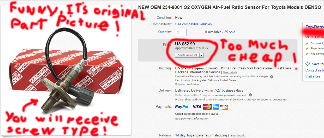

    1. too much cheap to be true (see the original part in picture, they send me screw type with same part number!)

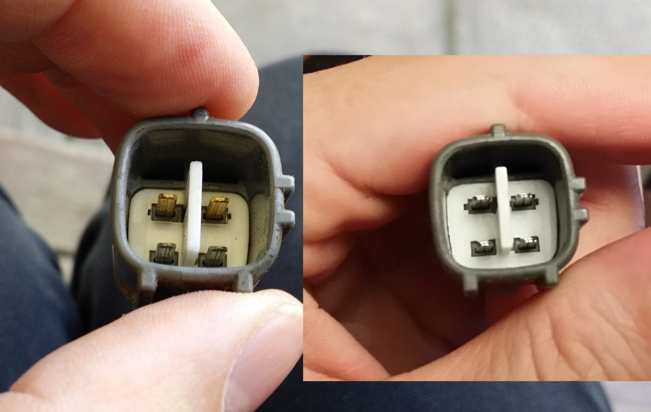

    2. The plug gold plated signal terminal tab, left original, right copy

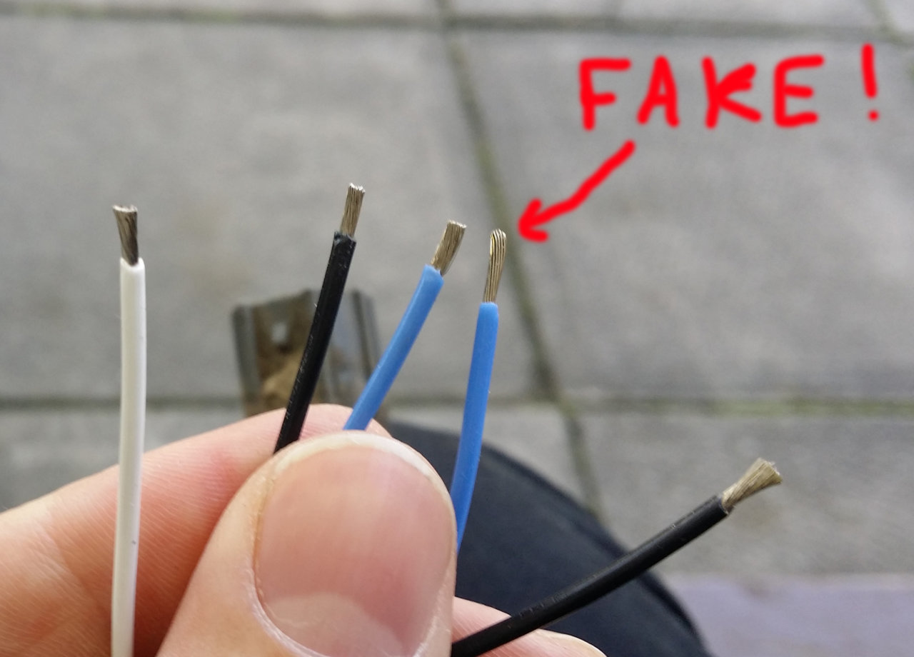

    3. There a lot more strands on original, softer wire... you need to cut it to see... ;)

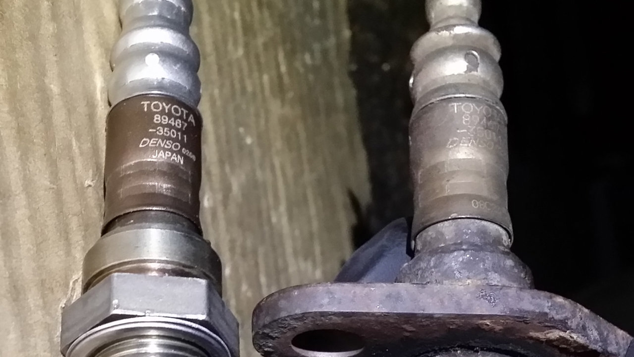

    4. Laser writing Toyota and other font look wider, no Japan on original

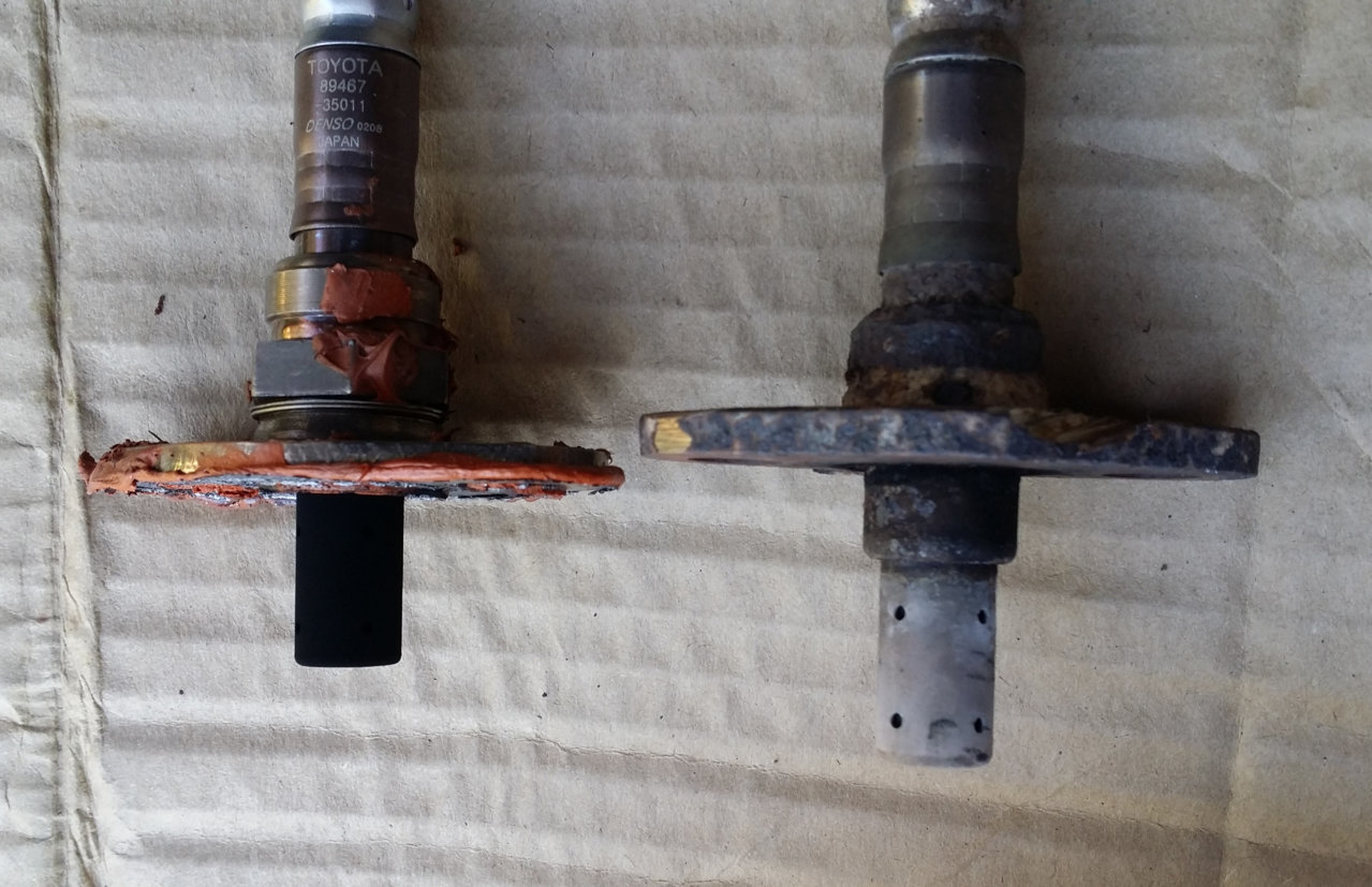

    5. Sensor screw type are shorter, not go far in flow of exhaust (see how much DARK it is from extreme too much rich mixture, I did 350km with a full tank!)
