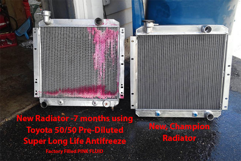

    If your gonna run a champion.....its highly suggested not to run the Asian red coolant...
    it seems to attack the welding flux in some applications...and other dissembler metals.
    and probably playing hell on some of the metal gaskets.........its a crap shoot.
    heck of a lot easier to find them leaks THO....

    The new Prestone Max is rated for 15yrs /350K miles...
    I figure springing for a $15 gal of that every three years wont hurt too much.....
    way cheaper than an etched gasket....
    and it doesn't count on protecting by coating the aluminum(pink slime).....crazy ass toyota engineers....
    As far as champion radiators....I have years on mine and tens of thousands of miles.....
    just have to follow the rules........nothings written in concrete....
    they have evolved here, wallet driven data........
    The champion has 1.5 times the volume of the denso one.
    Slides right in....even with the shroud.....
    Only negative I can say is they are not for off road tacos....they can crack under the extreme.......

    Quote:
    therefore would use extra thick bushings on the four mounts regardless of the truck.......
    and made it so two of those can slide......[/QUOTE]
    Well I suppose it depends on which generation champion you get. I ran one for several years, even tried preemptive 1/4” thick bushings, and it leaked from about year 3 on. I thought it might have been the radiator cap( that’s where I saw the most evidence of leakage. It never over heated, and I kept an eye on the coolant levels- the leak wasn’t too bad at first, after about 4 years(since installation) it progressively got worse, I noticed when I got underneath to look for the source of the strange noises this last AlCan trip, I saw evidence of a leak coming from the tube sheet, and that was the clincher. So I went with the Koyorad VH010513. Fit was good and it has good clearance above and below.
