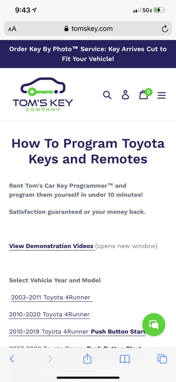

    I lost one of my factory keys. Wanted a replacement and didn’t want to pay the 450 for one key!
    I looked for a way to do it myself.
    I found this company called Tom’s Key.
    https://tomskey.com/pages/how-to-program-toyota-keys-and-remotes
    I watched the video and gave them a try.
    https://m.youtube.com/watch?v=BMvE9N5VYWA
    I programmed two keys in fifteen minutes. I now have 3 keys. I am storing my last factory key so I always have it and now have 2 others.
    Never lost a key in my life. Then you have a blue heeler who can randomly select a new chew toy! The key didn’t survive, but my pup was a champ and has lost his taste for keys after passing that thing.
    I really recommend this company and want to see them succeed further due to how easy and inexpensive they have made this process compared to high dealer costs.
