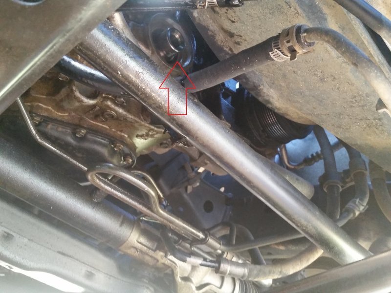

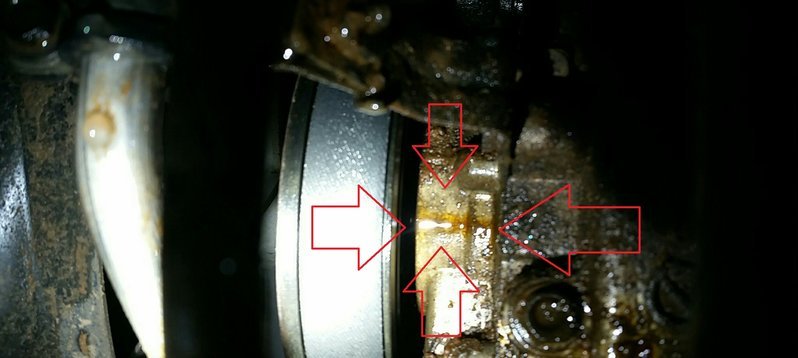

    I had an oil leak it was very slow and wouldn't show up when I was idling. After wiping off some areas and driving I determined it came from the front crank shaft seal. (You can see the stream surrounded by arrows in the picture)
    This is laying down under the engine looking up

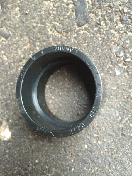

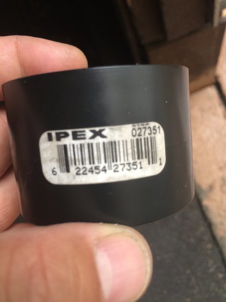

    Pvc pipe coupler the same diameter as the seal (To install the seal)

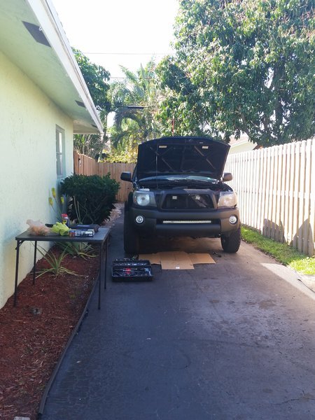

    Find a shady spot and layout your tools

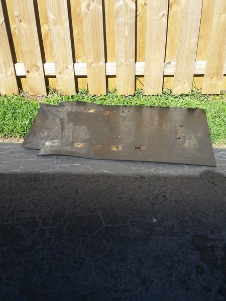

    Remove your skid plate

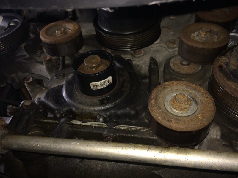

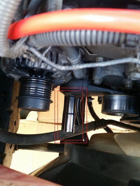

    Remove the belt...there is a helpful bolt thing on the tensioner that a socket connects too where you then rotate it to the right which loosens the belt. (I put 2 red squares around my socket which is connect to the bolt thing)

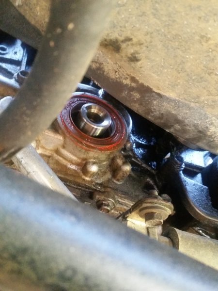

    Remove the seal
    Use a seal puller working around the seal until it pops off
    Reinstall the seal...Coat the outside only of the seal with the rtv. Since there is little room I used the bolt in method where you use a piece of pvc pipe the same size as the seal and with a washer slowly bolt and check the seal. (There is plenty of media online showing how to do this.)

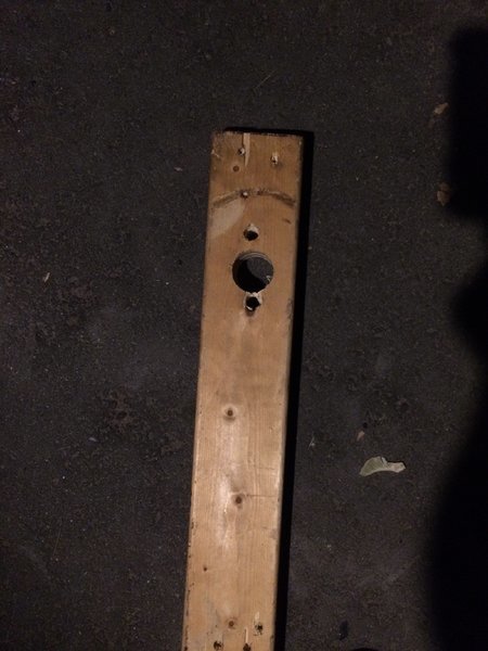

    This is the home made tool I used to tight the big bolt. I don't know how 5 lug " slap the bolt in" . I think it is hard to toque it to 185 f.p without a right tool.
