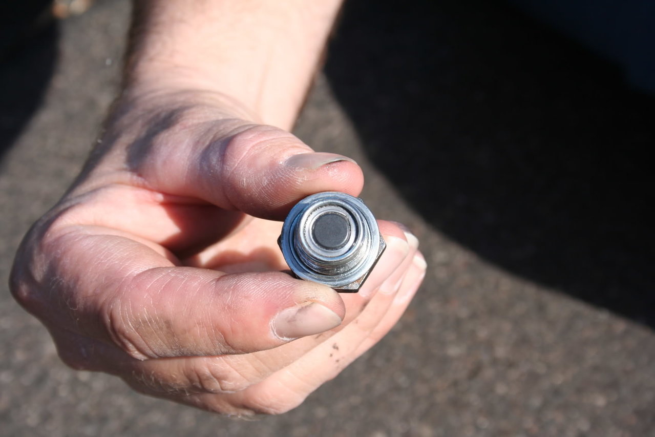

    Great write up. Over 10 years old and still a great reference. I changed mine today. The rear diff and the transfer case oil was really dark so I will do the front diff tomorrow.
    question — the transfer case did not have crush washers on the fill and plug bolts, but the rear diff did. I put crush washers on and torqued to spec. Should I remove the crush washers for the transfer case?
    THANKS AGAIN!

    No. Some may debate their value, but there's certainly no harm in having them.

    Not sure what you mean?? The transfer case does have washers, they are just plain flat aluminum like the engine oil pan washer... They do crush a little since they are soft.
    This kit has all the required washers. The transfer case ones are in the middle.
    https://www.amazon.com/dp/B07PSKNJQ...uPWNsaWNrUmVkaXJlY3QmZG9Ob3RMb2dDbGljaz10cnVl

    The crush washers are much smaller for the drain and overflow plugs. The 24mm fill plug has a rubber ring around the bolt that you can hopefully reuse. I ordered the crush washers from Amazon. 35178-30010

    I haven't seen a rubber ring on any of the drain or fill plugs and i have changed all the fluids once already.
    The front diff, transfer case and rear diff use copper, aluminum or steel.
