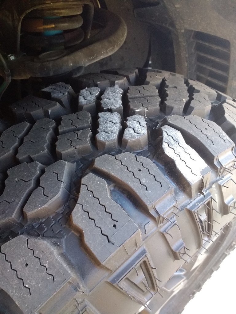

    I recently upsized my tires from the stock 265/70R16 GY Kevlars to 265/75R16 GY Duratracs. Tire shop set the pressure at 35psi. I did the chalk test after work when the tires were warm and resulted at 30psi. This made the cold tire pressure at 28psi in the morning. Is 28psi to low for my daily driver and nothing in the bed? Others here on TW have these tires up to 36-44psi?
    I'm thinking to raise it to 30psi cold (just like the door jamb says) since both are C-rated tires and specs show max loading at 2470 lbs at 50 psi for both. Maybe the chalk test is correct and the extra 2psi will compensate for passengers and/or gear in the bed?
