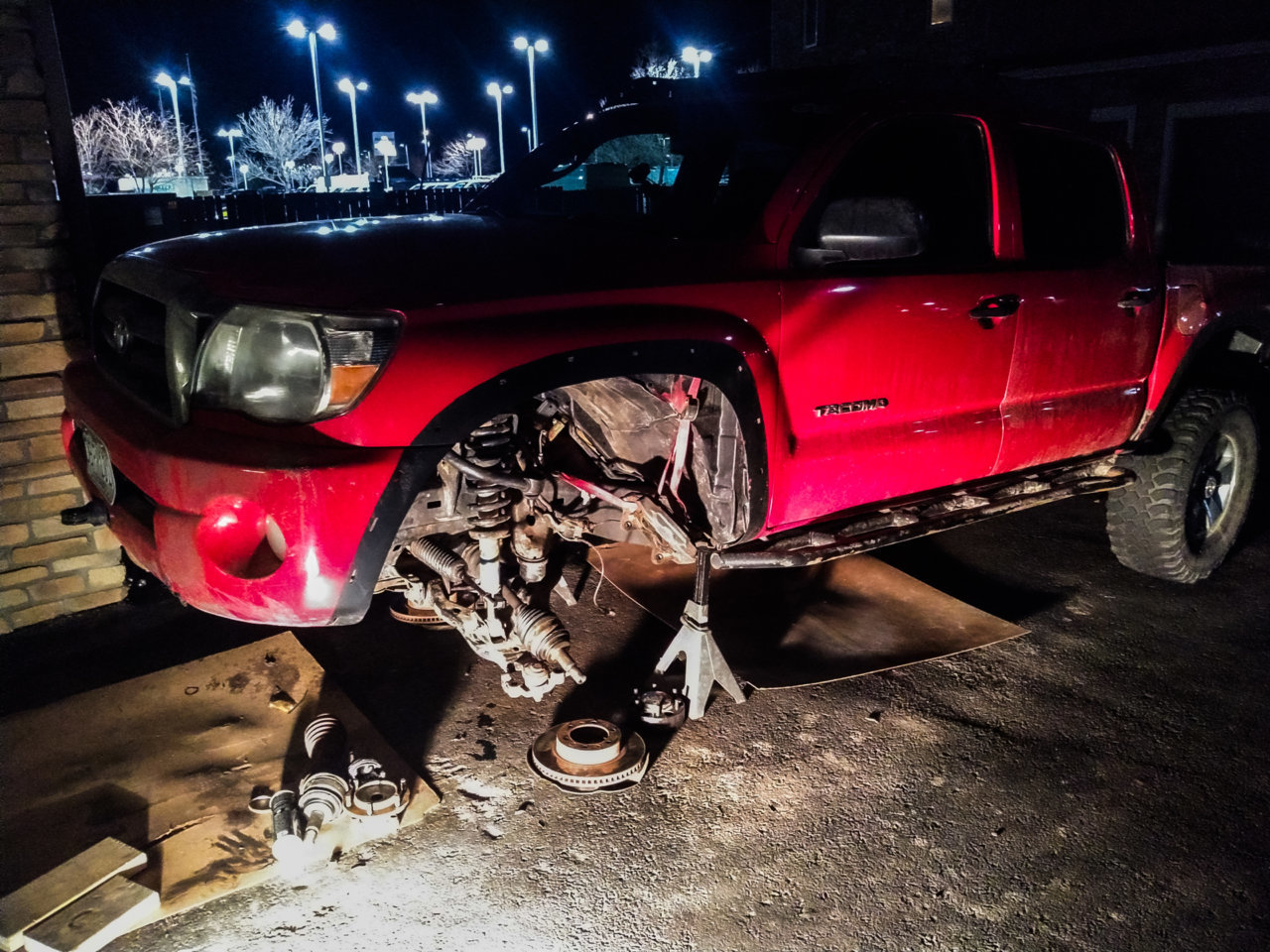

    The 350 mile drive home in FWD was not fun, especially when its snowing.

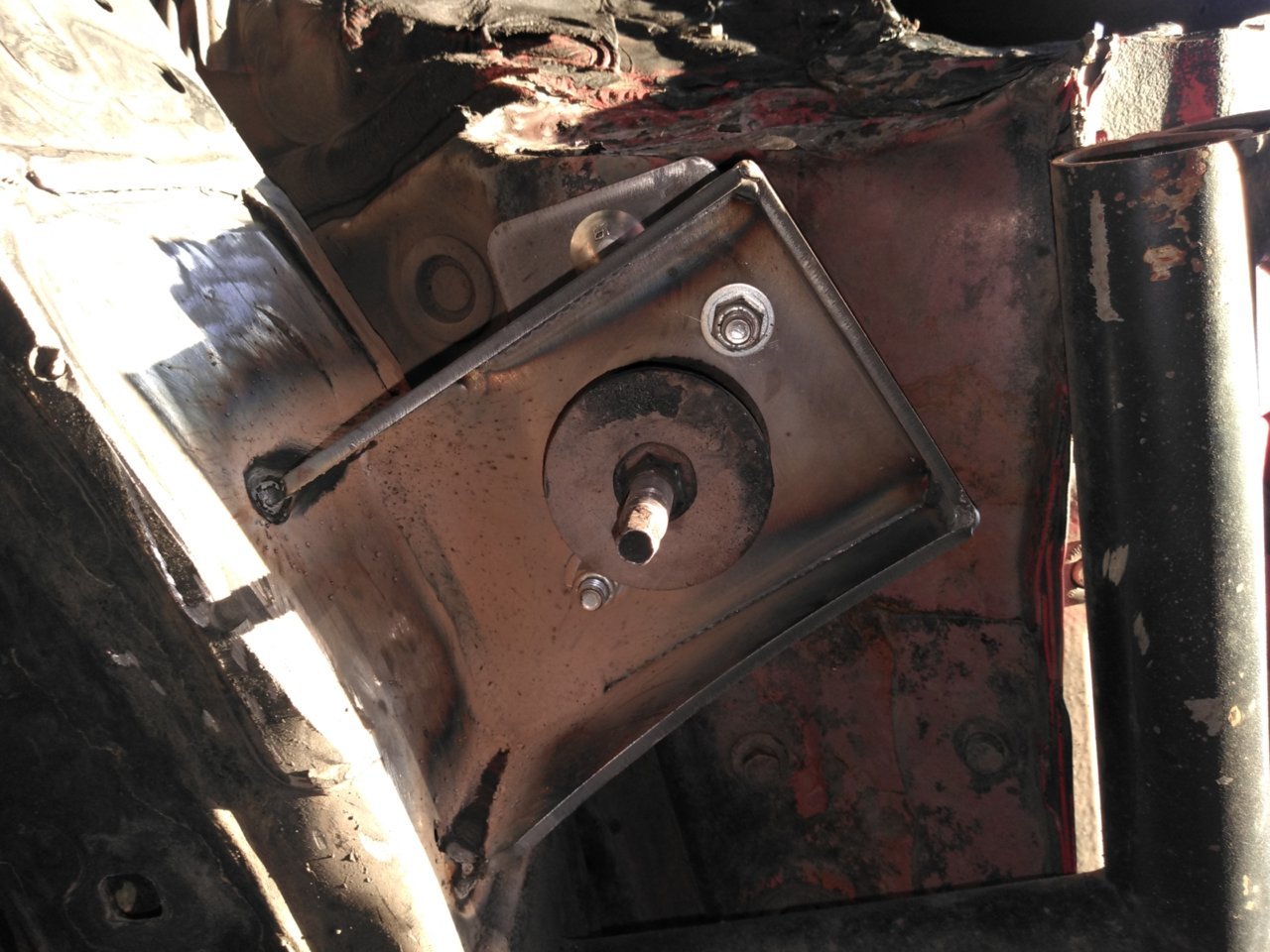

    I was hoping to put off a cab mount relocate till after Moab, a little rubbing it fine for me but this was catching the tire on the cab mount bolt and stopping it in 2wd. So I ordered a red goat fab cab mount relocate and so far I dont rub, even in reverse. I still rub frame but that's a whole other issue I don't care to address at the moment.

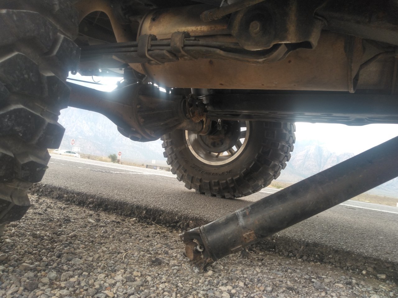

    I've taken it on the trail once already and it did amazing. But I did break my rear driveshaft flange when I was getting back on the highway.

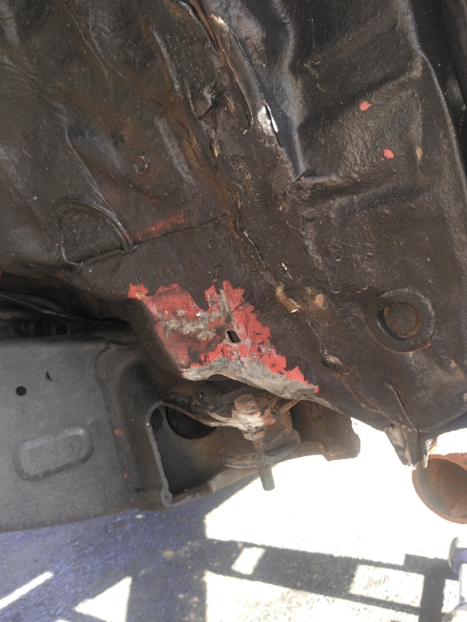

    I was an idiot and hit a huge rock at about 20mph and messed up my steering. Weird thing is, the rack looks straight and tie rods were fine, but the steering was binding while turning right.

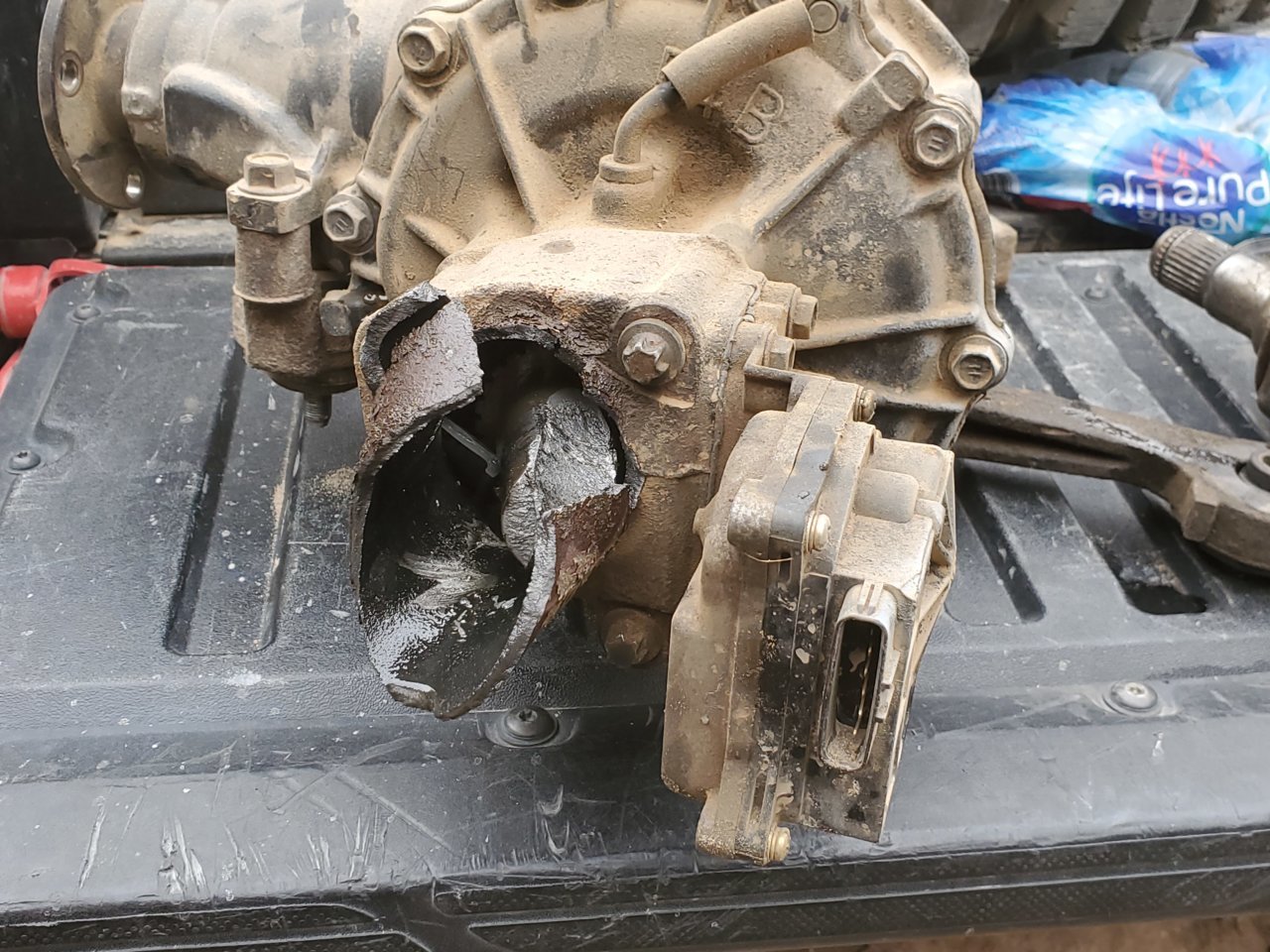

    I got home and it took me a while to figure out what broke, the gear on the ADD actuator stripped and for the life of my i couldnt get it all synced back together. So instead of fucking with it for another week and possibly missing our sand hallow trip that was less than 2 weeks away, i decided an fj case would be the best solution. I also ordered a rear locker wiring harness and button, front range shifters and a steering rack. The wiring harness, steering rack and shifters all shipped super fast, but the damn tcase came monday and we were leaving thursday morning and i worked all week. So it was alot of late nights for me working on the truck to get it ready, but i got it done and had a blast at Winter Jam in sand hallow.

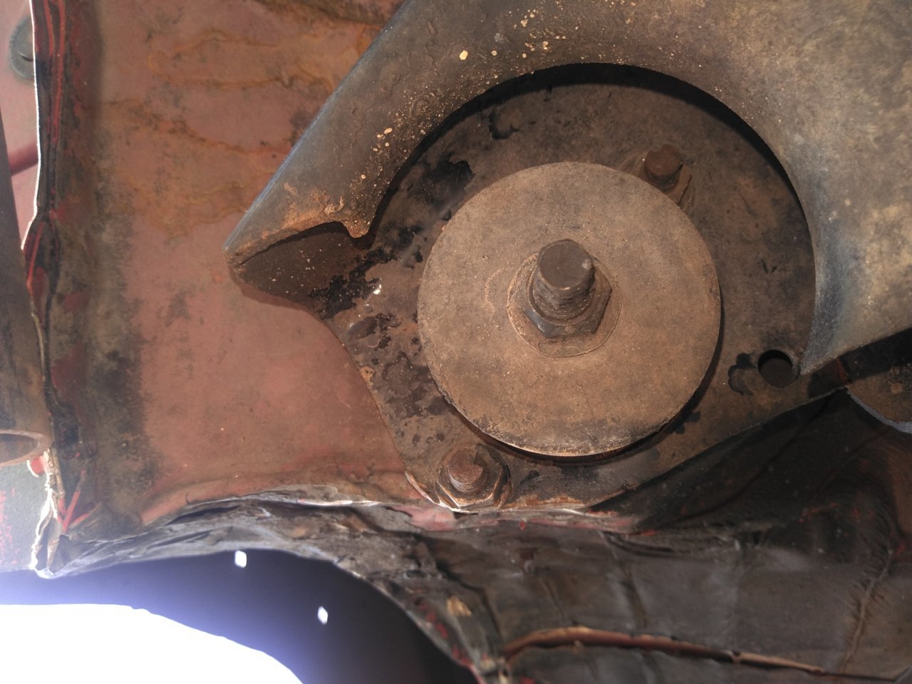

    I was still unsure of this project at first, so i wanted to retain my factory rack mounting locations. The first time i had the full hydro in the rocks i knew i would never go back.

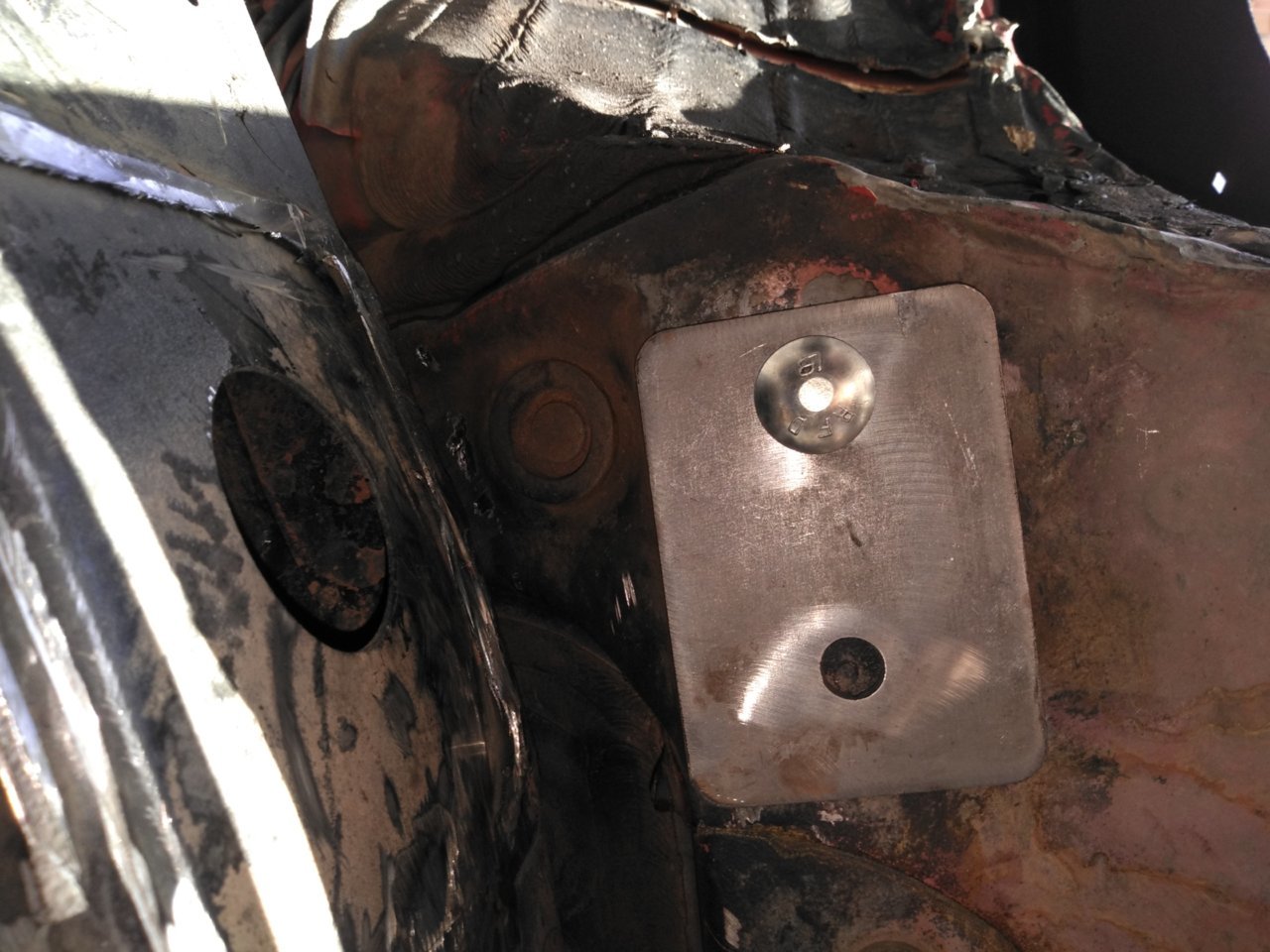

    I also added marlin crawler cam gussets ( they fit terrible and i hate them, but they work and strengthen the lower control arm mounts better than others) i also added cam eliminators.
