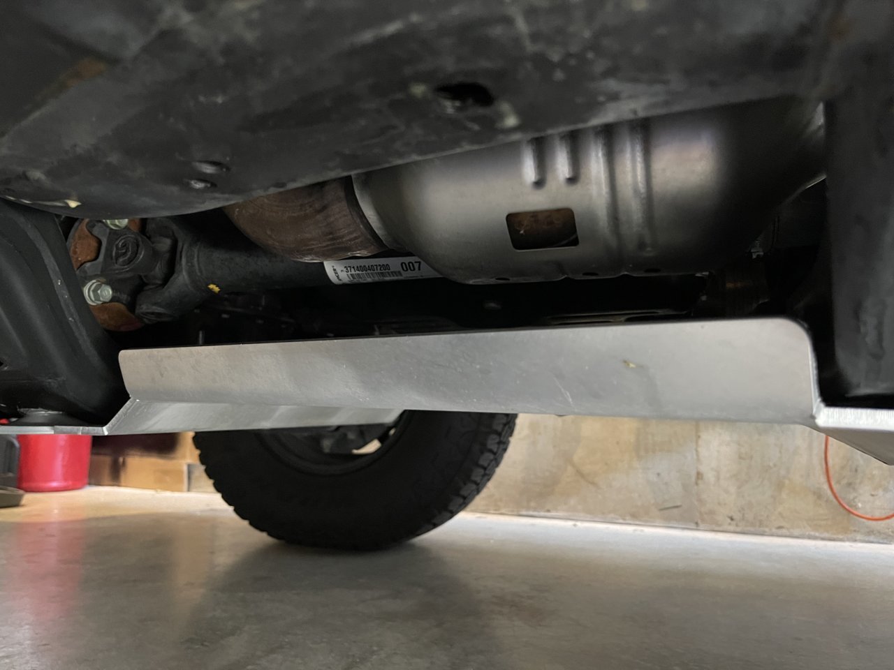

    :thumbsup: Just installed the Catalytic Guards. Not as easy to drill through my steel skids, but they wern't too bad. I installed them a little further back then the directions suggested. Very happy with this purchase, lots of coverage and I don't know how someone could get in there now.

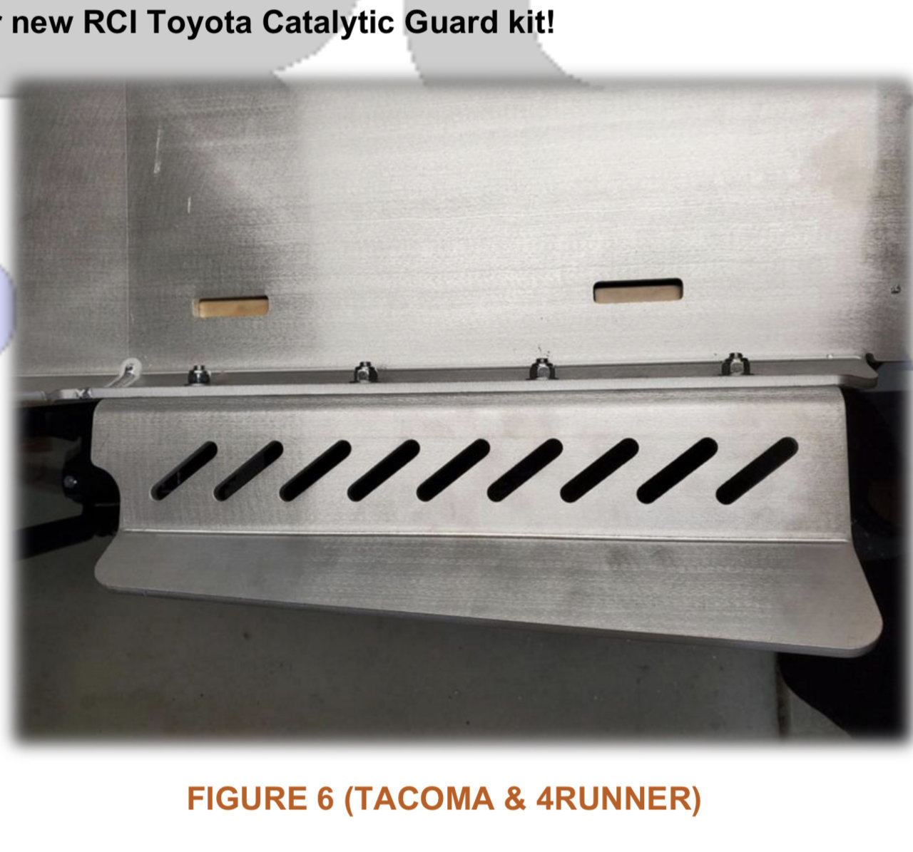

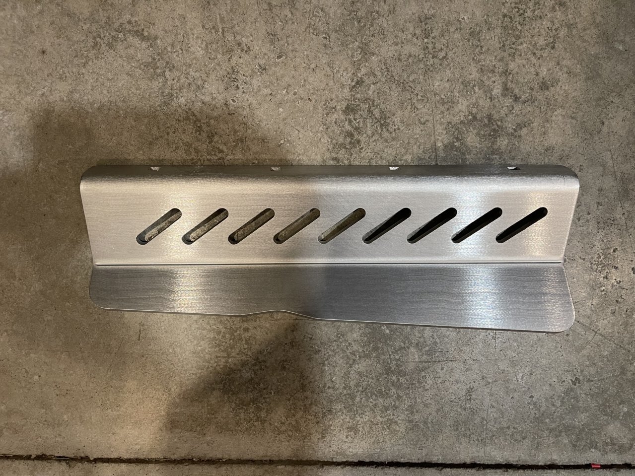

    Looking at your instructions it seems to show an older model with a notch on the NARROW end. The notch is said to be for alignment bolts. Clearly your instruction’s pictures show the NARROW side with the notch toward the FRONT of the vehicle.
    “There is a notch on each of the CAT Guards designed to accommodate the alignment lugs for the front suspension. That notch will need to face towards the front of the skid plate.”
    In your response above you answered a question where the poster said he put the NARROW side toward the FRONT of the vehicle, which would be correct with your instructions.
    He noted that the OP has them mounted with the WIDE end toward the FRONT of the vehicle.
    “but based on OP's photo it looks like the CAT guard "wings" are oriented with the WIDEST part facing towards the FRONT of the vehicle. Is that right?”
    Then you responded to the poster that the OP installer was correct……..but it seems he has the WIDE part toward the FRONT of the vehicle.
    So my question is which way do they go???
    WIDE end toward FRONT?
    NARROW end toward FRONT?
    The first picture is from your instructions and has the notch on the narrow end which goes to the front according to instructions.
    The second picture is of the version I have just received on 9/8, and they do not have a notch on the narrow end. Only a side notch.
    Please advise.

    The cat guards have had some revisions over time to improve the part and the retrofit process for those customers that had our transmission skid plate prior to our catalytic guards being on the market.
    The narrow portion of the catalytic guard will face the front and the notch on the outside portion of the cat guard will align with the frame rail. Checkout the below images and let us know if you have additional questions![​IMG]

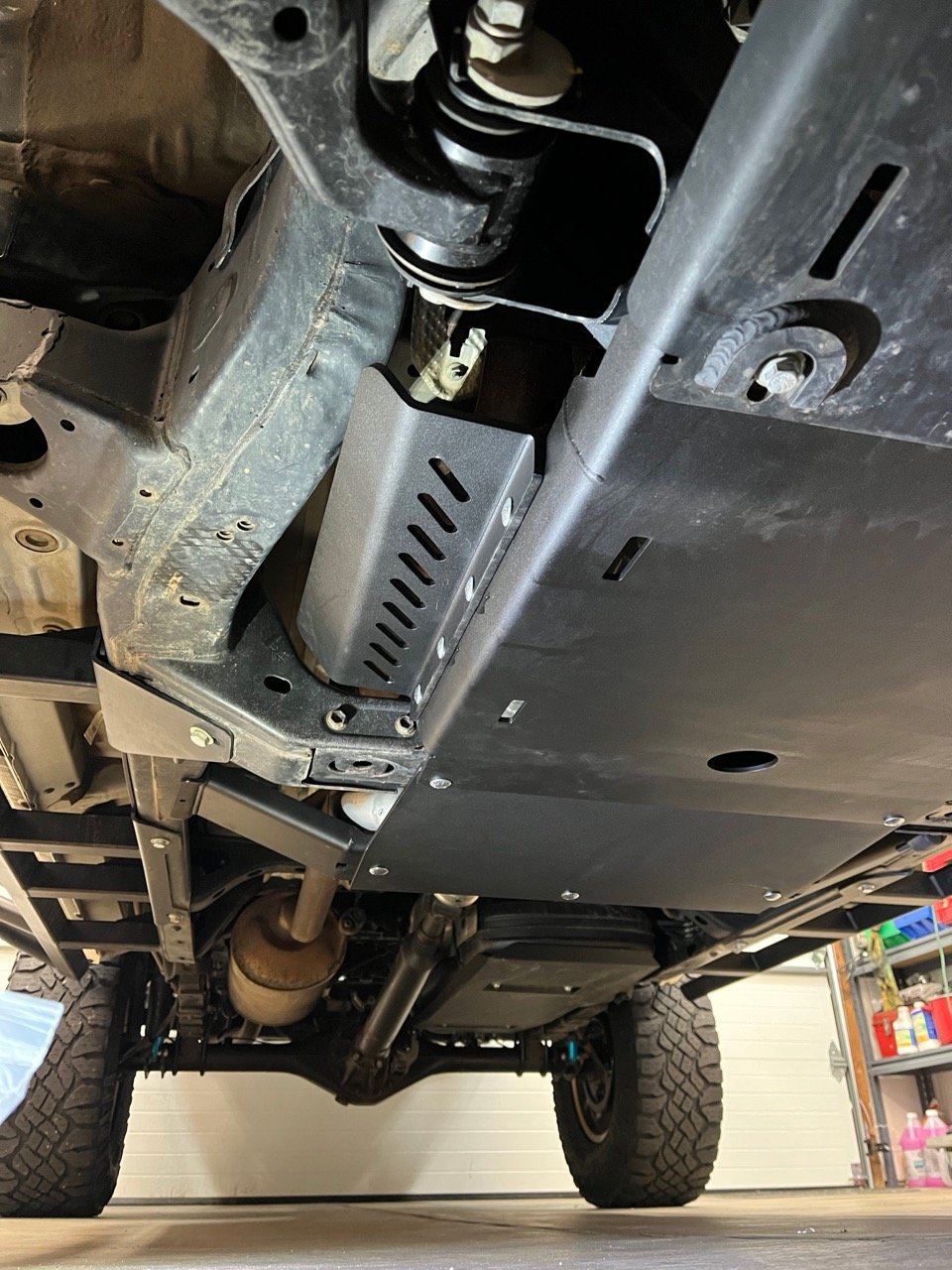

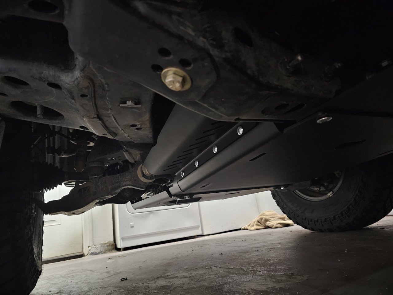

    @RCI-Offroad Thanks for the response. I’m actually retrofitting mine onto CBI skids. I haven’t installed them yet but test fit them and it should work. My skid plate bent lip is not quite as wide as yours but it will bolt up to them just fine. Glad you guys developed these.
    Here is a pic of the CBI skid edge.
    I’ll post some pics once I get them bolted up

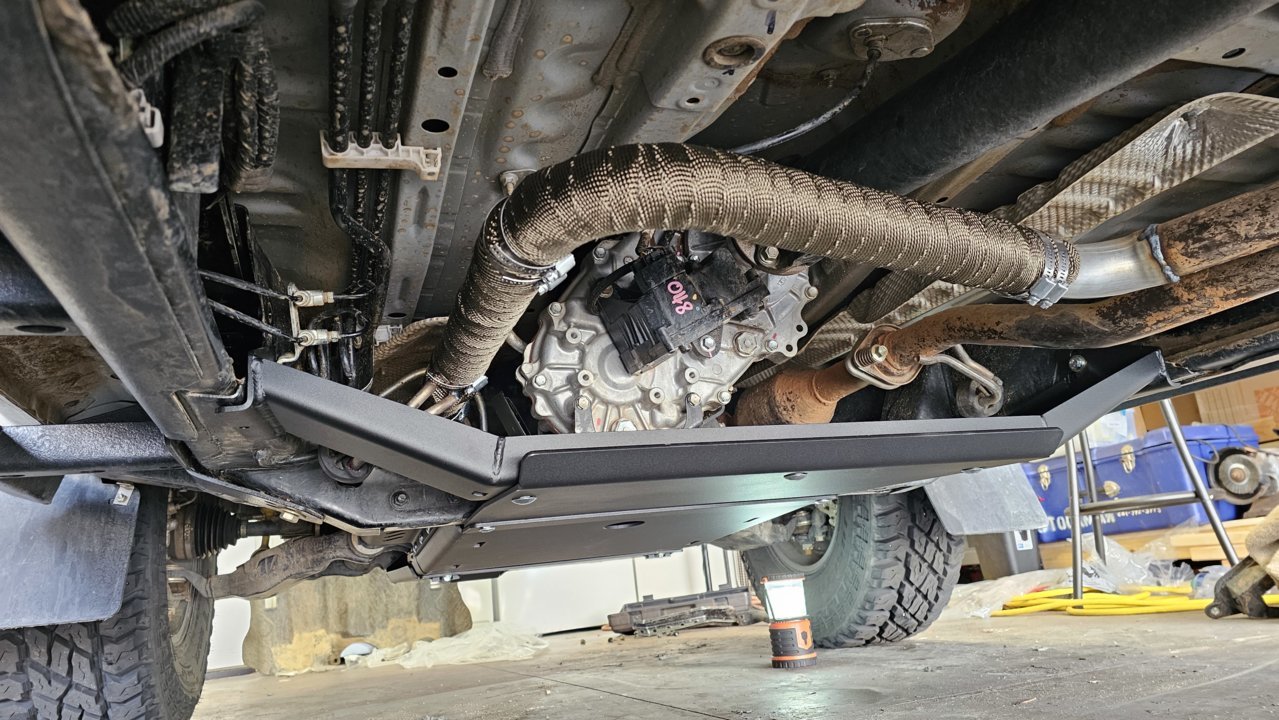

    Installed skids/cat guards this weekend. I appreciate that RCI is pre-drilling new skids for the cat guards.
    I did the aft route for the exhaust and wrapped it because I was paranoid about heat issues.
