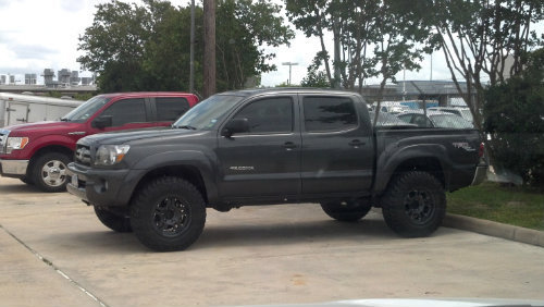

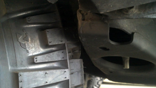

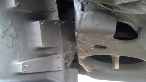

    What do you do when your suspension comes up and back and you are THIS close. Im worried that more caster might not move it forward enough... that it might take like 5 degrees or something ridiculous. Anyone made caster adjustments to gain clearance?
    And to those guys who think you are gonna clear 33.5" or larger tires or 12" or wider tires without MAJOR MAJOR reconstruction or a drop bracket lift... you are crazy!
    Here it is under compression
    And how high the lift is

    My alignment guy pushed the caster forward till I lost camber. Camver went from 0.0 to 0.3 left and 0.1 right. Caster is 3.5 left 3.6 right. It moved my wheel forard exactly 1 finger width... so 1 degree = roughly 1 finger width for future reference lol. My wheel is centered in the wheel well and I cannot make it rub anywhete now..
    Clearance is 3 red cunr hairs... but I dont rub and I am approaching Amarillo on my way toDenver and handling is great.
