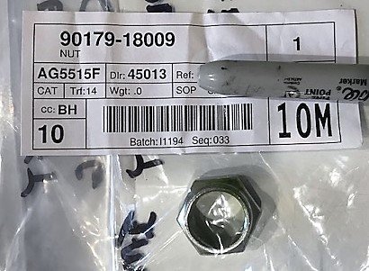

    I'm getting all the tools, parts and related stuff gathered to replace the U-joints and Carrier Bearing on my '06 Access Cab.
    The part I'm having trouble locating is the nut on the Center Yoke at the carrier bearing.
    What size socket fits?
    Will a Nylock nut be a good replacement for the staked nut?

    Thanks guys.
    I'm going to stop at the Toyota store to get the nut.
    Reusing staked nuts seems like poking the devil with his pitchfork.
    <edit> Stopped at Toyota. Ordered the nut. Its a whole $1.47. Parts dept had nada details on the hex or thread. Guess I'll find out tomorrow.
    <end edit>
    [edit] A little follow up. The nut has a 24 mm hex. The thread is 16 mm. Wasn't able to determine the pitch, but I know it is NOT 2.00 mm. The pitch is finer.
    [end edit]

    To button up the endeavor.....
    Yesterday was spent at Father-In-Law's shop. Pull front prop shaft, replaced both U-joints. Pull rear prop shaft, replaced Carrier Bearing and U-joints.
    Pre-packed the cups with grease, then used a grease gun to fill the cross piece.
    The U-joints were in reasonable condition, the Carrier Bearing fell apart when the yoke was removed. I believe this was the source of the shudder.
    The low speed shudder is gone.
    The most difficult step was breaking the nuts loose on the flanges. Not so much rust, just insane torque levels on the fasteners.
