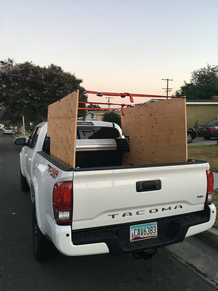

    I made some prototypes (out of necessity). Buying 6months of inventory for our business.
    These should fold down into the bed and fit perfectly between the wheel wells acting like a bed mat of sorts.
    1/2" bolt heads with a lock washer fit we (not perfect in the accessory track.
    Cargo straps to pretension the walls. Giant cargo net to secure stuff
    Will let you know how it works LA to PHX

    Has anybody looked under the rails where stake pockets would be to see if there is any? My sport looks like it has a knockout on the plastic bed rail caps in the stake pocket areas. Or is it just looks?
    Looks good op. Should be fine for what your doing.
