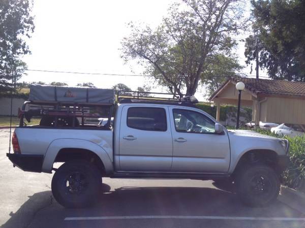

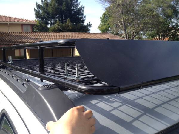

    Well, I guess you get what you pay for LOL
    The basket is a little on the cheap side, but I'm going to keep it. It's a little thin, but it's really noticeable compared to my BAMF bed rack. And it came in gloss, which makes it look even cheaper. I'll be repainting it with bedliner to give it a better look, and it'll match better with my bed rack. Oh and the hardware it came with won't work with the OEM roof rack because the u-bolts aren't long enough to clear the rails. I went to Lowes and got some 3" u-bolts (I actually had to cut the u-bolts because they were too long, then I flipped them upside down from the picture below, so that the threads were facing downward)
    On the other hand, the height is perfect for me because it lines up with my RTT, so the fairing on the basket has dual purpose.

    OP - those baskets looks nice! making me rethink my cheapo basket :(
