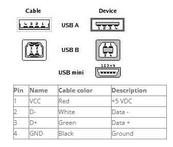

    there are only 4 wires involved in the usb connector...and two of them are not necessary for charging.
    the 2 inner wires are Data+ and Data-. They are only important if you are connecting to a serial bus or possibly involved in quick charging.
    The two outer wires are Power and Ground. you need these to charge.
    to easily test a usb port for power, i made a simple converter that feeds a couple of VOM/DMM connectors.
    I just plug it into the meter and read the voltage across Power and Ground.
    I'd start there to know where to look next.
    Of course you could just probe the connector in the dash but be careful not to slip and apply 5volts to data lines.
    Much safer making a simple converter at the cost of a usb cable. everyone has too many laying around.
    and it is handy next time. there will be a next time. :)
