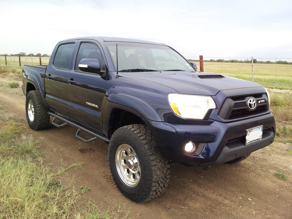

    265/75/16 S/T Maxx 16X8.5 Level 8 Trackers 5100 1.75 HID, LED interior, 3" N-Fab step bars
    Ask the guys at Discount and see what they say and report back.
    I have a similar situation. I have Level 8 wheels that are 16x8.5 and my tires are 265/75/16 which are rated for 7"-8" wide wheels.
    As you can read in this article there some allowances. To be honest, my discount said .5" was not an issue and there had to be a cutoff range. If there was a problem I doubt Discount tire would have installed them. I researched extensively and I never found a single complaint about a tire failure due to this issue.
    If you think about, it is only stretching the rubber .25" on each half of the rim...that is about the thickness of the tire itself. That is not a big deal. Going 1" or more obviously is going to distort the fitment of the tire and cause problems.
    http://www.tirerack.com/tires/tiretech/techpage.jsp?techid=198
    They look fine on my truck.
