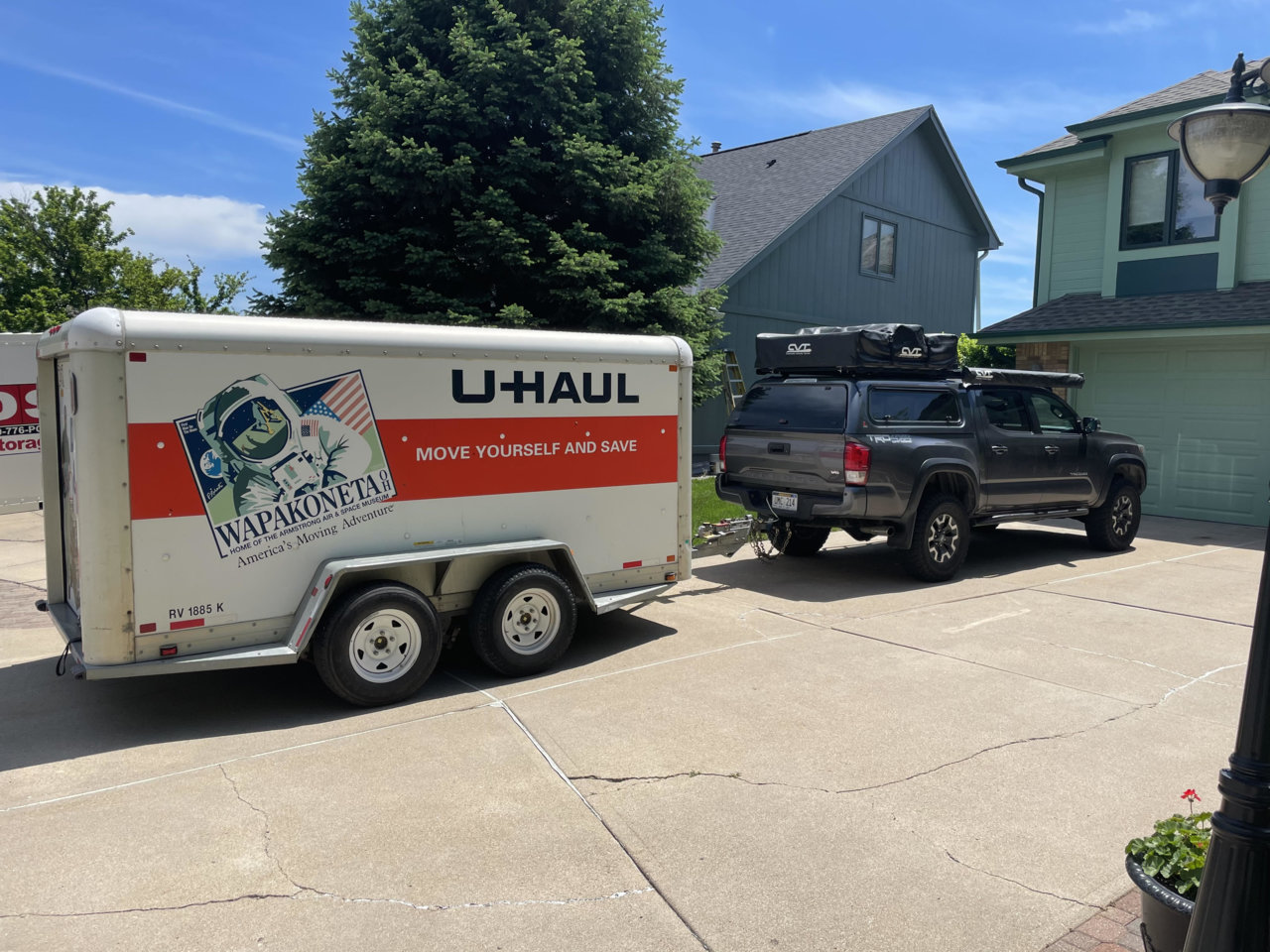

    Hey guys I was wondering if Its okay to tow a mattress, a tv, some tools and some clothes on a 2005 Tacoma 2.7l Automatic 2wd 5lug?
    Uhaul says yes.
    Uhaul would be 6x12 Enclosed Trailer.

    I'm going with NO! I see oversize tires on that truck which further reduces power. I also see a cap and several hundred pounds of gear on top of the cap. You have to also consider payload capacity, not just tow capacity. As long as you load that trailer light, the truck will just barely pull it with stock tires.
    ASSUMING you can keep the total weight of the trailer and cargo to 3500 lbs that will eat up 450 lbs of your payload. The cap is another 200 lbs. Just a guess but let's call it 300 lbs for the other "stuff" on top of your truck. That gets you to an estimated 950 lbs added to your truck. The payload varies depending on the individual truck (it is printed on a sticker on the driver's door jamb). But around 1000-1200 lbs is typical. You could be around 1300 with a 4cyl and 2wd. But that only leaves you 50-350 lbs for the driver, passengers, and any other gear in the truck.
    If my weight estimates are way too much and if I'm mistaken on the oversize tires, then it will be close. If that is the case, I might be willing to do this for a short trip. But not something cross-country.

    Truck in the picture is a 3rd gen. OP is asking about a single cab 2nd gen. I venture a guess the picture is just to show the trailer.

    Why’s the picture of a third gen with v6? I confuse

    It’s there for confusion…..:rofl:
    Either way, 2nd Gen 2.7 or 3rd Gen 3.5, that trailer is back there. And you’ll know it’s back there.
