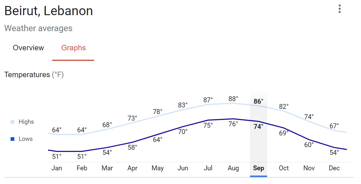

    Is it really hotter than Houston?

    Oh yes lol

    Per Google- the warmest average month in Beruit is Aug with 88 F as an average temp
    Per Google- the warmest average month in Houston is Jul/Aug with 91 F as an average temp
    I think you're fine with factory fill

    hmmm weird. Feels way hotter here. But the summers last longer for sure. We go to the beach from may until October. Winters here are also mild.
    And thanks. I’d rather stick to factory even if it’s more expensive
