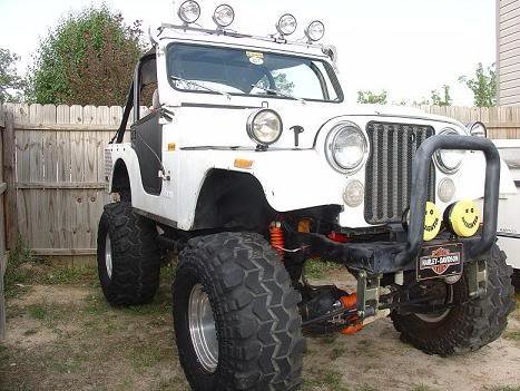

    Yeah, the tire companies have a recommended size wheel for each size tire. But people regularly run MT's & AT's wider than what's recommended. It gives the tire that bulged look on the side & actually helps protect the wheel.
    Here's the 15.5's on a 10" tire...
