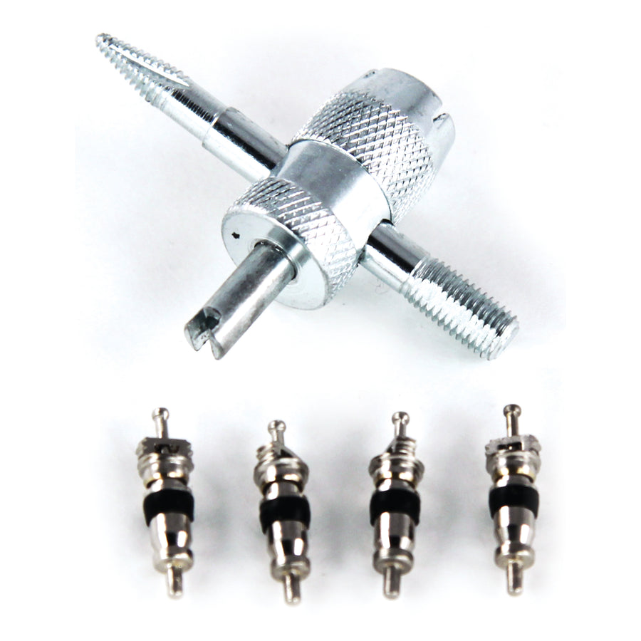

    Those are the cores, yes thos can be replaced without removing the tire.
    ToyoTaco25 and eurowner like this.

    Those pictured above are valve cores. Which can be replaced as it sits. You can also replace the stems without removing the tire but you have to break the bead in order to gain access. So yes, but you still need access to a tire machine.

    Do you mean the entire stem or the Schrader valve inside the stem?

    There is a technique with a floor jack and ratchet strap to pop the bead. I can elaborate if needed. I replaced all my TPMS sensors. It was time consuming but not terribly difficult.
    Replacing the valve cores is easiest. Actually even easier is to just use a valve core tool to make sure the cores are not loose.
