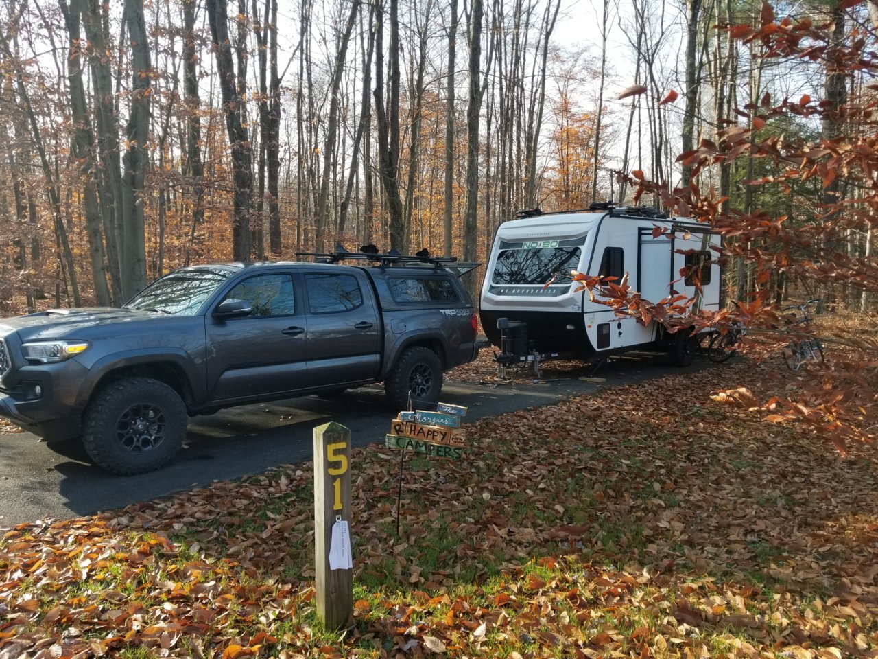

    I have a NO-BO with about the same numbers and it pulls fine
    lynyrd3 likes this.
  13. Sep 21, 2021 at 4:04 PM
    xringer
    xringer Well-Known Member
    Jun 28, 2015
    #158308
    61
    2019 Tacoma TRD Sport
    This is it
    New2You, lynyrd3 and TacoManOne like this.

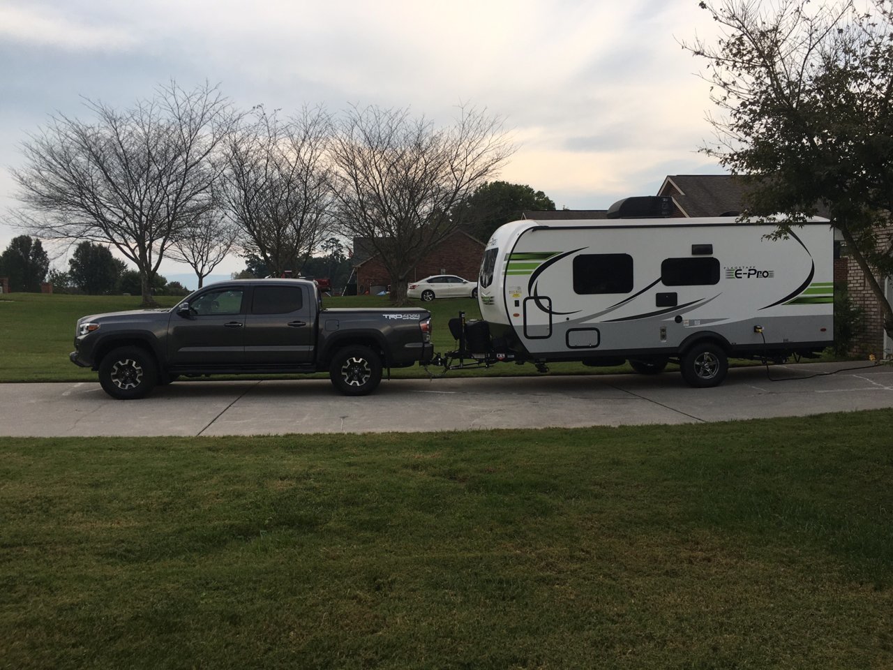

    2021 Flagstaff E-Pro 19 FD, same unit as the Geo-Pro. Total here about 3800 with E-2 Equalizer hitch. Hooked up with 770 miles on the odo. No problems, do not expect any, towed with with an '18 4R before this pickup, all good.
    Picture here before the E-2 installed. Using Tekoshona Primus IQ Controller.

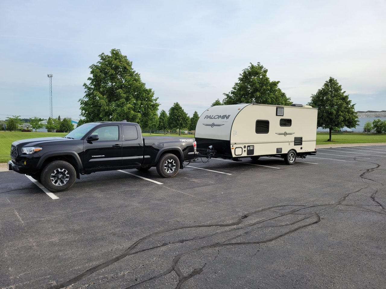

    I tow almost exactly this and it tows great!

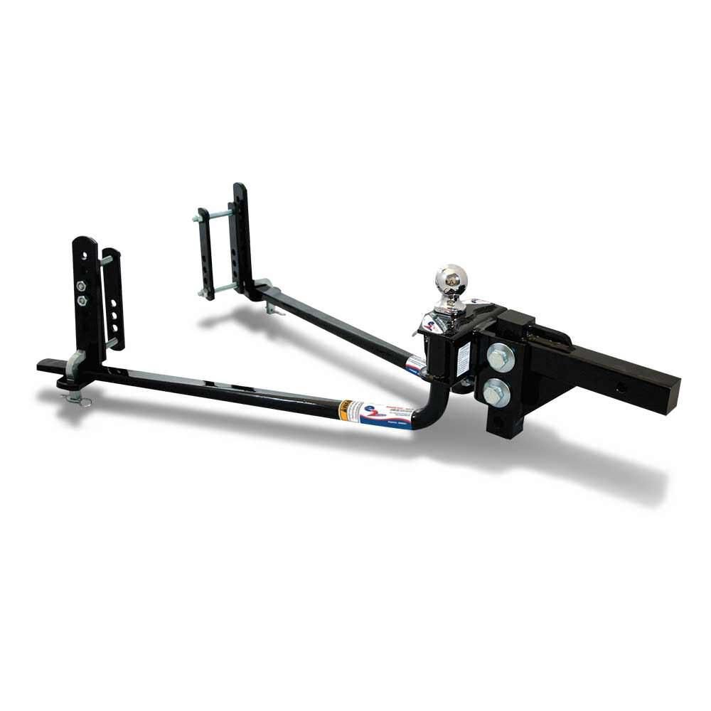

    It's gone well. We have taken it on a few more trips down into central oregon. I did change to the Equal-i-zer 4point (https://www.amazon.com/gp/product/B01MAWXHHO?ie=UTF8) hitch setup and it is SO much better than the reese! Super smooth and the sway control is much better, highly recommend. With the transmission cooler pinned open I never hit trans temps above 180, monitored with a scangauge 2.
    I have 2 issues that are worth mentioning (I've changed my setup since), first is that my taco is lifted using the ome 2.5 kit and this makes towing a bit worse as it allows much more air under the vehicle in high winds which makes sway worse, this was mitigated with the better hitch though. The 2nd is that I have a 2 battery setup and this trailer is already a bit heavy on the tongue so be aware of your payload. I have been towing over factory payload by a couple hundred lbs but not worried due to e1 rated tires and the upgraded suspension with medium load leafs in the rear. No real sag in the back and just about an inch higher in the front. Set the WD hitch to lower the front back down by .5 inches and it's good to go.
