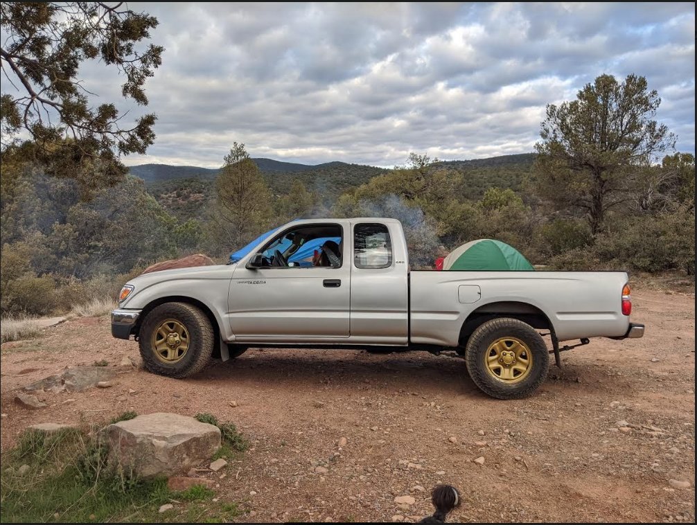

    here's what mine looks like with the 235's. I only have mild rubbing at full bump but plan to do trimming soon

    Yeah those look great do you know by how much they offset? also are you also on stock suspension?

    stock suspension, also using stock rims. Are u looking for new rims? I just went with a bigger and wider tire. With wider rims it would poke more, but with 235's on stock rims I'm flush with the side of the fenders
