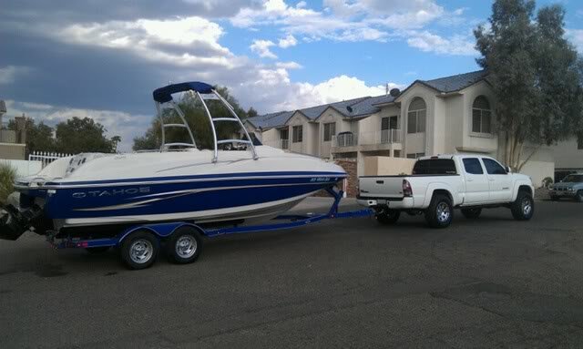

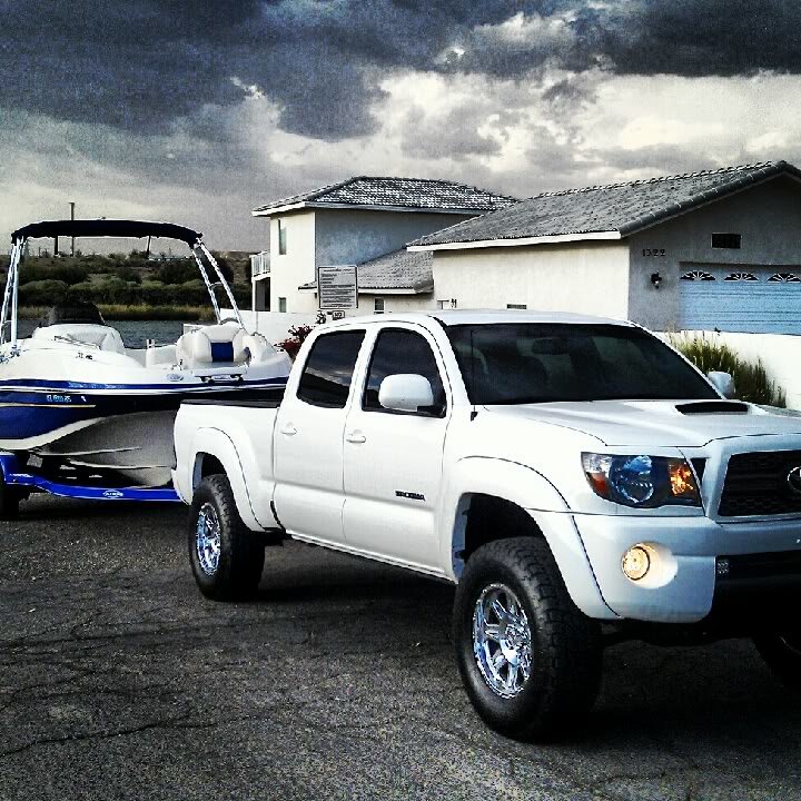

    I pull this guy around with no problems. 4,112lbs. full of fuel, and Idk what the trailer weighs..

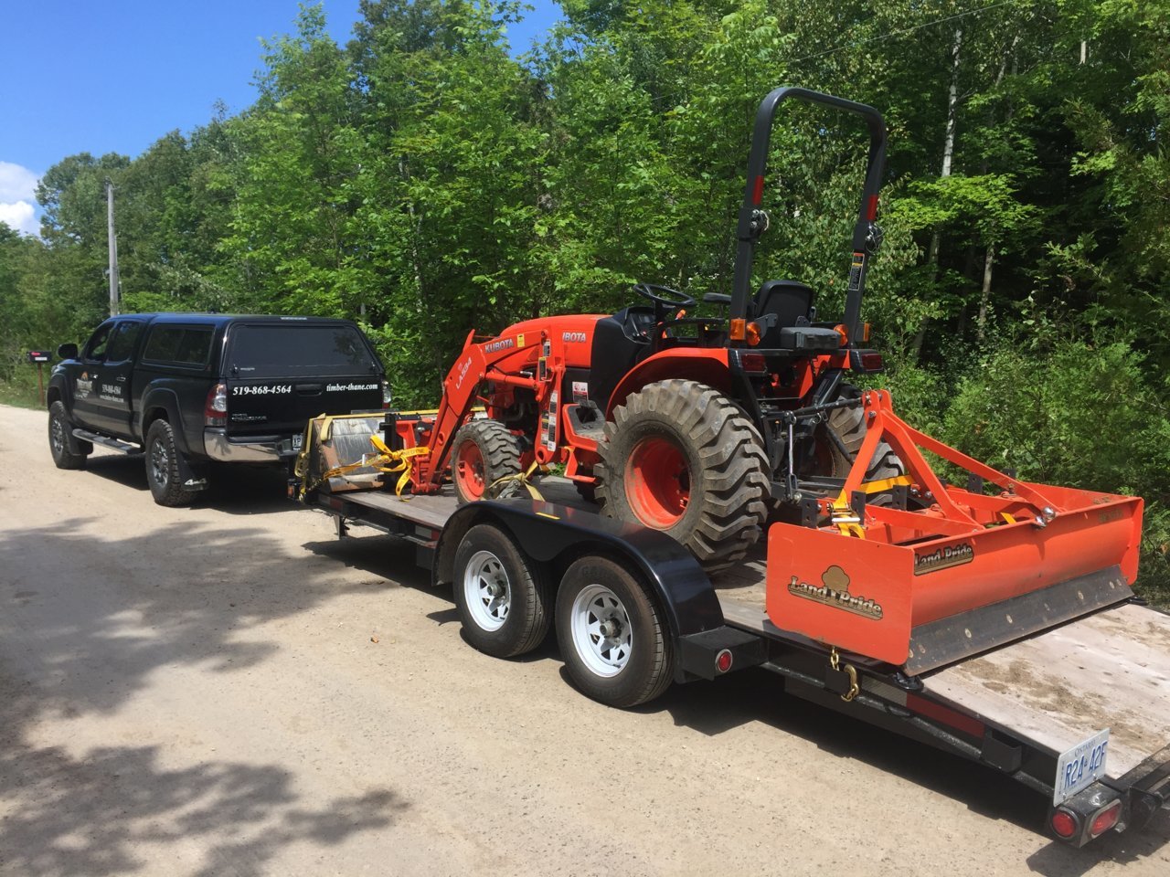

    I own a small timber Frame company and my 2013 Tacoma Limited is my work truck. First off, like all other trucks (excluding heavy duty), the rear suspension is too soft and it squats too much when a lot of weight is put on the pin. I had two more leaf springs installed and I run 10 ply rated tires. Now it can carry the max pin load and payloads without feeling like it's overloaded. I have no problem hauling the maxim weight or pulling the maximum weight all day long. These are flatbed trailers and they pull at lot nicer than travel trailers. I have a 23 ft Forest river Surveyor that loaded is about 4500 lbs and its bitch to tow compared to a 6000 lb flatbed trailer. The Tacoma is not a full size truck but it is a truck and will pull and haul two thirds as much as a standard full size truck. For me it's all I need.

    Man Steadfast you make her work!
