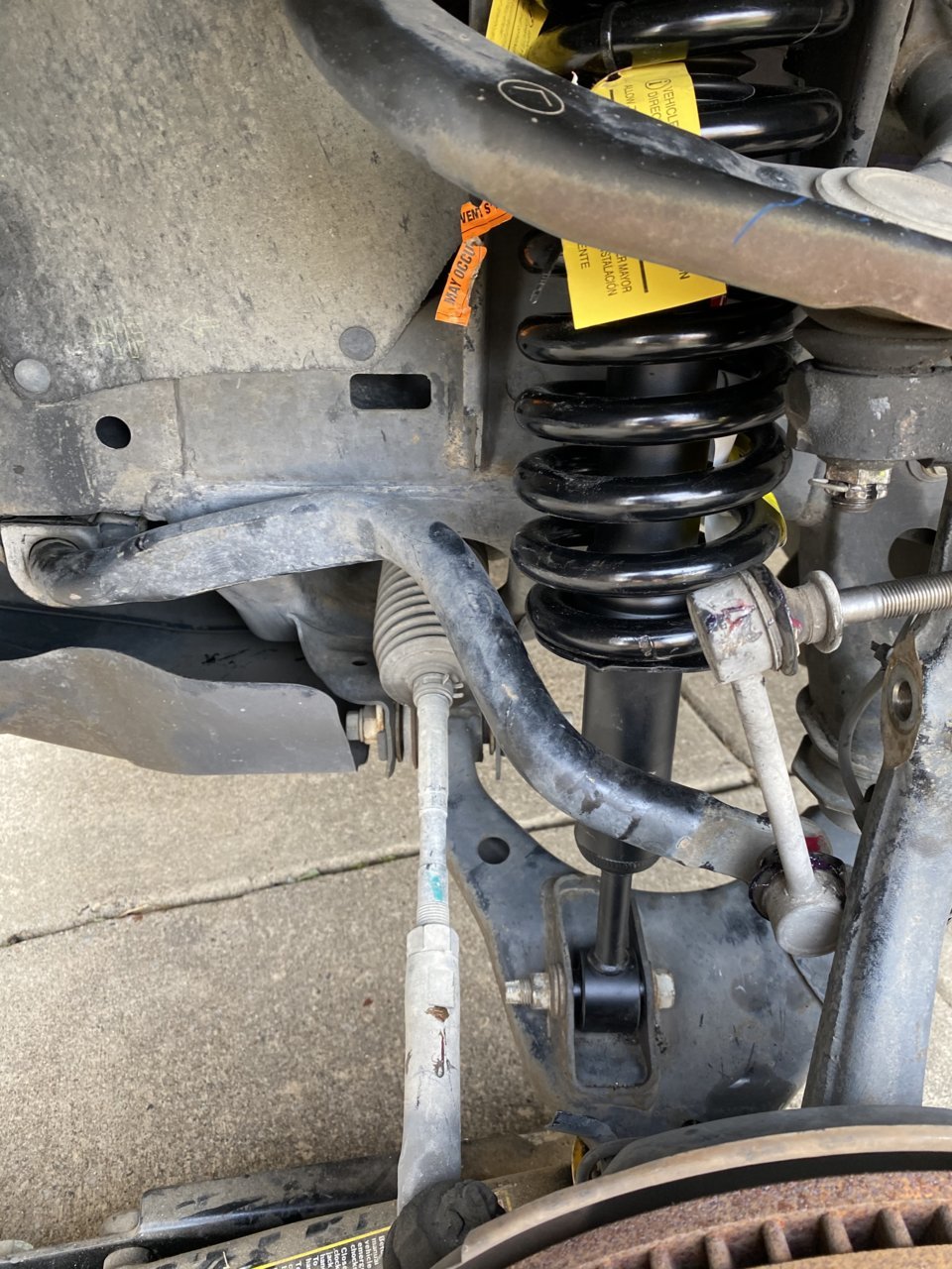

    Just wanted to chime in and let you all know how much I appreciate these posts and guidance. Was installing my Bilstein 6112s this evening and ran into this very issue. Would’ve been lost without these solutions. Crisis avoided. 39032B32-EE5F-482A-B37E-F7260C1BB983.jpg
