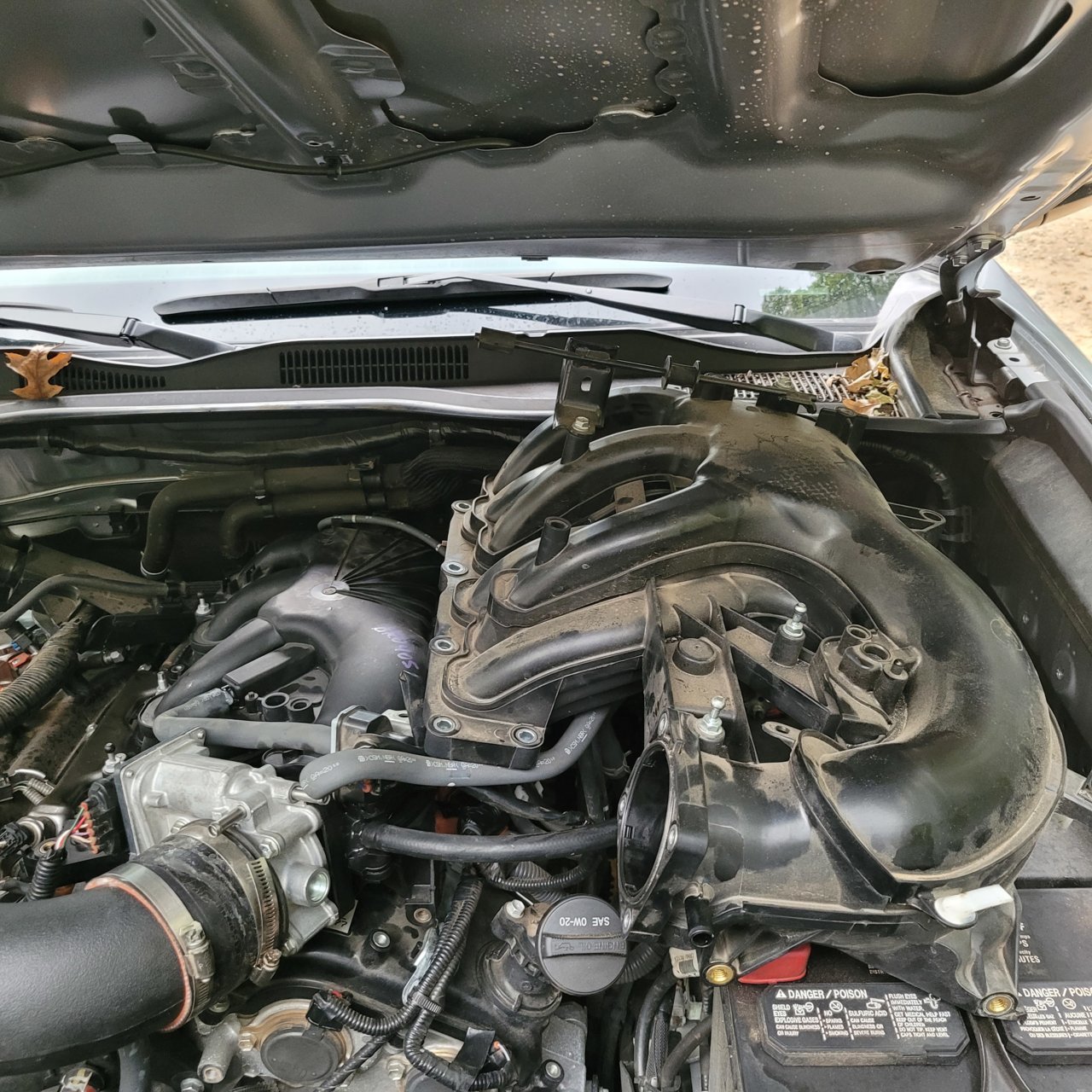

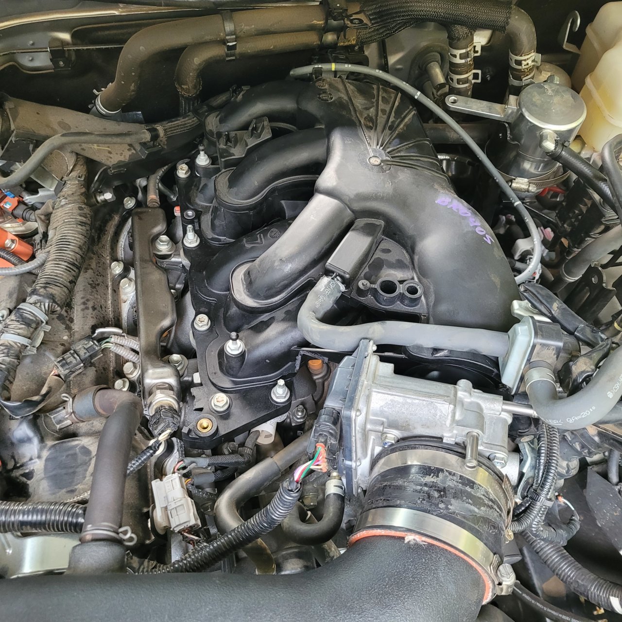

    Here you go.
    I put the truck intake back for some more comparison and also to do some mild work on the Camry intake. The change in performance is quite noticeable.
    Interstate passing or 40 roll that camry intake is just much stronger.

    Looks like a Gen2.5 TRD Sport, but really an '08 TRD OffRoad
    TRD Supercharged / OTT Tuned
    Very interesting and good job executing!
    I wonder what the difference is between manifolds besides that contour near the TB. Runner length and/or shape? Size/volume?

    2020 trd off-road
    I measured the ports and they are identical to size at the lower intake but the shape from the plenum is different.
    If I had to guess the Camry intake loses 5-6 inches of runner length and adds a bit of plenum volume.
    After switching back to the truck intake the difference is very noticeable.
    The only place the truck intake is better is below 3500-4000 at wot and then part throttle high load such as a tow situation.
