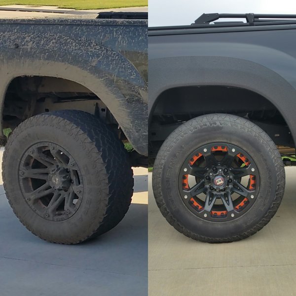

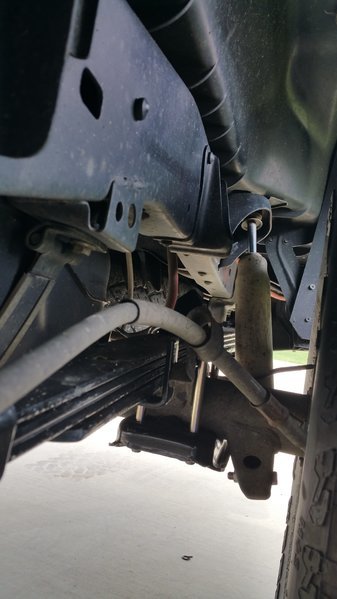

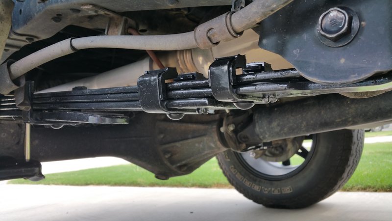

    Here are some pictures of my new springs. They are completely flat to the point of a slight negative arch. My shocks are compressed about an inch or more than they were pre-recall install. The picture of the tires shows fender height before (dirty) and after (clean) install of recall leaf springs. It easily sits an inch and a half lower in the back.

    Mine also seem to be flat or also have a bit of negative arch

    My old once already have negative arch.
