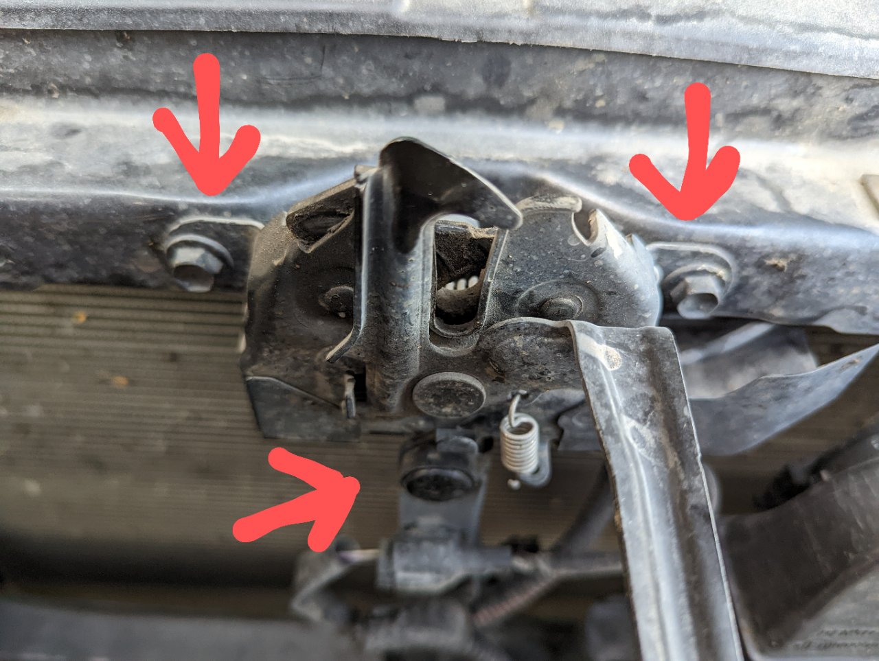

    2022 SR5 -- OK, the cable came off the hood latch and I can't open the hood (my fault)- now the hood is closed and I cant open the hood .. Suggestions before I get destructive??
    Thanks in advance

    is the cable all the way off or is just the jacket loose?
    If the cable is all the way off, good luck. The latch is held by three bolts, one of which has a security cover glued over it. You'd have to get some extra long arms, defeat the cover, and snake a socket up there to undo all three bolts.
    I don't have the puzzle skills to suggest how to attach the cable or coathanger it from the underside. It's purposefully protected by it's own mechanism.

    This happened to me before. I used a long skinny stick and unhinged it through the grill.

    Dying to know if op got it open and how

    Got the hood open, it was not my fault, I originally thought I had hit it when installing a light bar --- I carefully remove the three mounting bolts and was able to pop the hood- - the puck at the end cable was gone, so I got it covered under warranty
