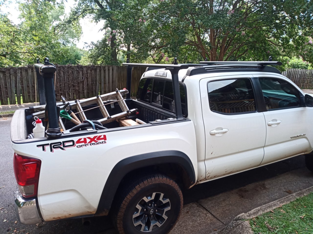

    Hi- I have a 3rd gen double cab short bed that currently has a TracRac setup with some custom mods, but it keeps breaking. I'm a residential contractor and haul a significant amount of lumber on the top of my Tacoma. I have an additional crossbar mounted to my cab. A dozen 16' pieces of lumber is the norm for me.
    I am looking for a full replacement of my current setup. This will most likely be a cab rack + a bed rack & matching rails at the same height as the cab. I have been reviewing Victory4x4, Prinsu, CBI, upTop, etc... and I like most everything I see. I am struggling to confirm some dimensions though...
    The most important thing to me is one continuous roof rack height from the cab onto the bed. Just like my current setup. I need a flat plane for lumber.
    It seems many have done this with a fiberglass camper shell, but not with a full height bed rack. A camper shell would not work for my purposes.
    I am very open to mixing and matching brands with some spacers / fabrication.
    TIA

    Keep in mind that the rear bed moves & twists independently from the cab. If you've secured your load to all 3 cross bars (as you should), this is going to introduce forces to the rack elements that they're not really designed for. Particularly if you're traveling over uneven terrain.
    The disadvantage for you is the short bed. While the lumber rack that Ghostdrifter88 suggests is better (although the pic shows a long bed), with 16' lumber you may have some excessive front and/or rear overhang, and a significant proportion of the weight will be imposed on the front of the bed.

    The lumber rack does seem like the obvious choice. I carry 500-1500 lbs often and enjoy the weight bearing directly on the cab. I'm an engineer by education, and a builder by profession... Cantilevers are fun and cool, but when hauling half a ton of lumber above my roof line at 50mph.. I prefer to have something cab mounted.

    The TracRac upright has a top "cradle" that has 2 bolts that clamp into the bottom of the crossbar. I have sheared more of these bolts than I want to admit. I always replace them with the hardest bolt I can find, but that just makes it more of a challenge when they break again.
    I can drive up to 100 miles / day on decent roads, but I have a lot of railroad crossings. I think these crossings have contributed to my wear and tear.

    Initially I was using the factory cab rack as intended, but since I carry more than 1k lbs fairly often I decided they were not up for the job. They work great but I wanted more up there. I added the crossbar later and the rubber mount (yakima) ended up adding 1/4"+ to the height of the front crossbar. You have a good eye! Surprisingly it is a non issue when loading lumber. I will take a look at the factory mounts. I actually use the floor bed mounts in the bed and loop over the crossbars. It is much easier to release them when I need to.

    I had a TracRac on my '89, but it had a full-length rail on the bed side. The cross member that I would load also had 45 degree braces between the upright and the cross member. I never had any issues and carried some pretty heavy loads on the rack both on and off road.
    Given the way yours is attached to the bed side and the lack of a brace, I suspect there a lot more side-to-side flex at both the bottom of the upright and at the connection between the upright & cross member. Crossing railroad tracks at a bit of a skew would definitely create some side-to-side sway. That's probably what is shearing the bolts.
    You might consider strapping from the upright-cross member joint diagonally down to the bed floor tie-downs - on both sides (creates an "X") to combat the side-to-side sway. Do this both front & rear and I'd bet you don't get a rerun. Gotta tighten the straps equally though - just a tad better than snug.
