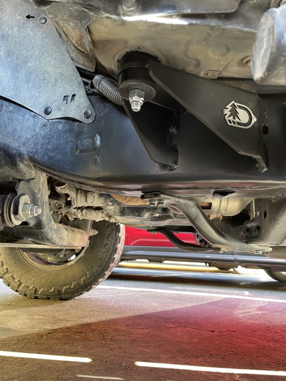

    I have the Alpine designs CMR kit had it done right before I made the jump to 35's, the DRT one wasnt out when I purchased my kit though it does look more stout IMO but I am not jumping my truck so the Alpine designs one is plenty beefy. I am running 35x12.5x17 tires now and I no longer rub the cab mount but I do slightly rub the firewall but with running 34's your mileage will vary, this will also depend on the UCA's you're using and how much caster you can get out of them as well. Additionally I did have to trim my fenders as I rubbed both front and rear when fully stuffed. Honestly I think you'd be fine with any of the CMR kits out there now.Cab Mount Relocate.jpg
