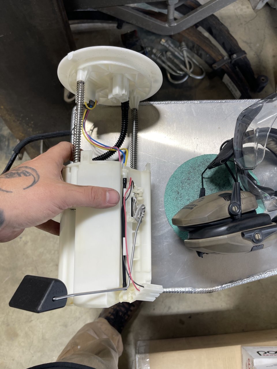

    Ok well I have some new news ……… The fuel pump on a 2016 + Tacoma’s is 3 wire brushless and the computer regulates fuel pressure with the pump. There are currently no other fuel pumps that won’t set off a check engine light. So if your designing a fuel cell or fuel tank ….. design it with stock pump….you can use an aftermarket sending unit. But after this experiment. I’m dumping the sending unit and just 103BC161-3B0A-4371-B770-977283D8FFA7.jpg 7806B9A7-F942-4C9C-B187-46CC5B340244.jpg using the faithful stock set up… F3A03E1F-D030-470E-AD11-8DCE73624A1E.jpg

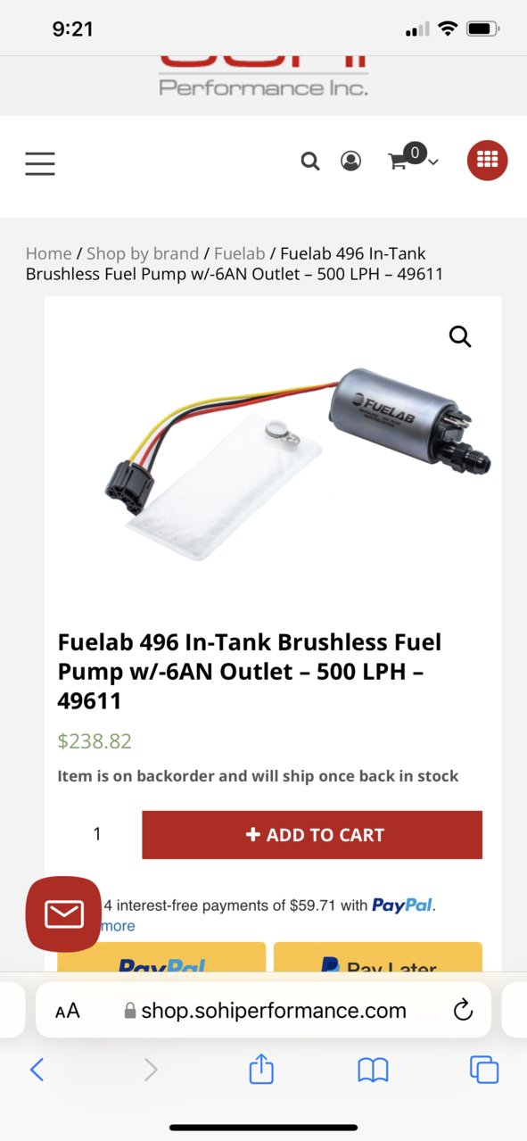

    I know lots of European cars are using brushless pumps and companies like torqbyte build modules to adapt them into cars that aren’t using them. Looks like fuelab has a 3 wire pump with a similar looking connector. I’m sure stuff is out there but finding a compatible pump is going to take time.

    Wow nice find Justin. I think someone needs to buy 1 and see. I agree it will take time.

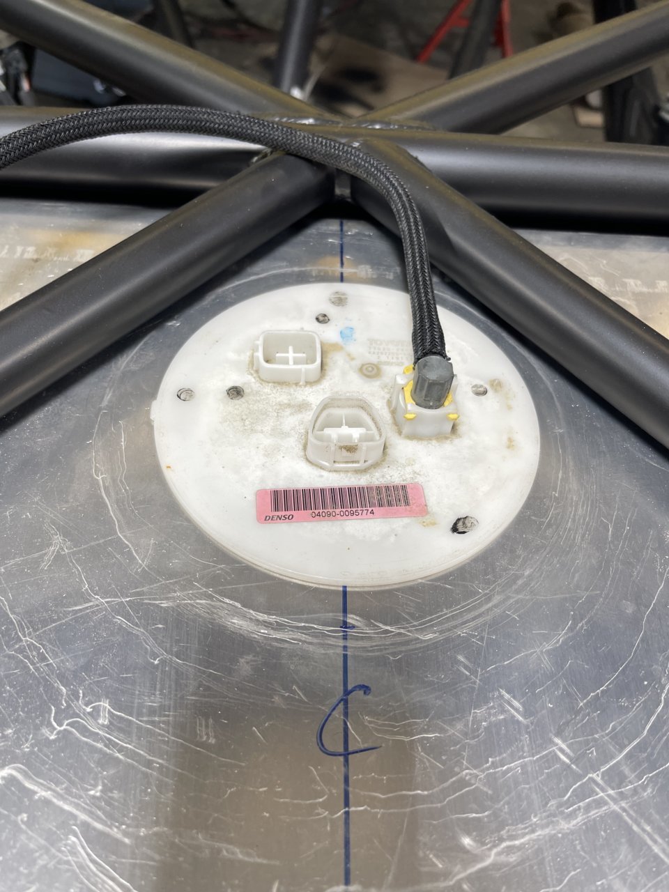

    are you making your own cell? Or is this one you bought with a bladder in it already?

    I had Solo Motorsports design engineer and order it with bladders. Had another fabrocation guy install it. 32 gallons I love it ….

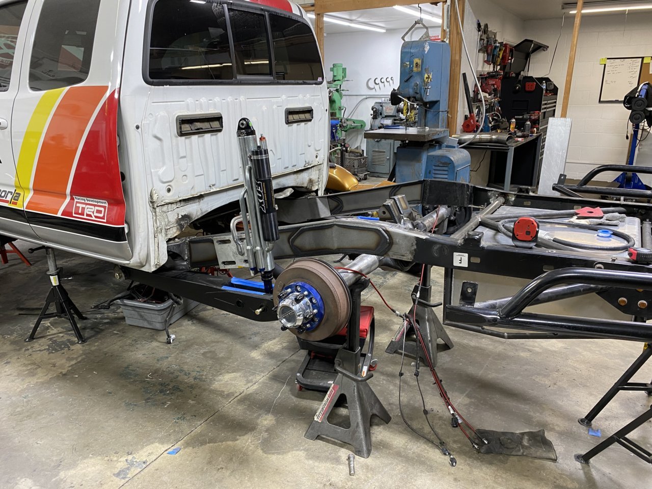

    I thought about a panhard bar but I want to back half the truck but I'm a little less concerned about it now since I talked to Bobby at Solo Motosports. As long as all the evap stuff is there and passes the sniff test for the gas cap, I'll be good. Also, Solo is going to make a tank for my Tacoma. I guess they've built several in the past and they have all the CAD for it. 32 gallons.
