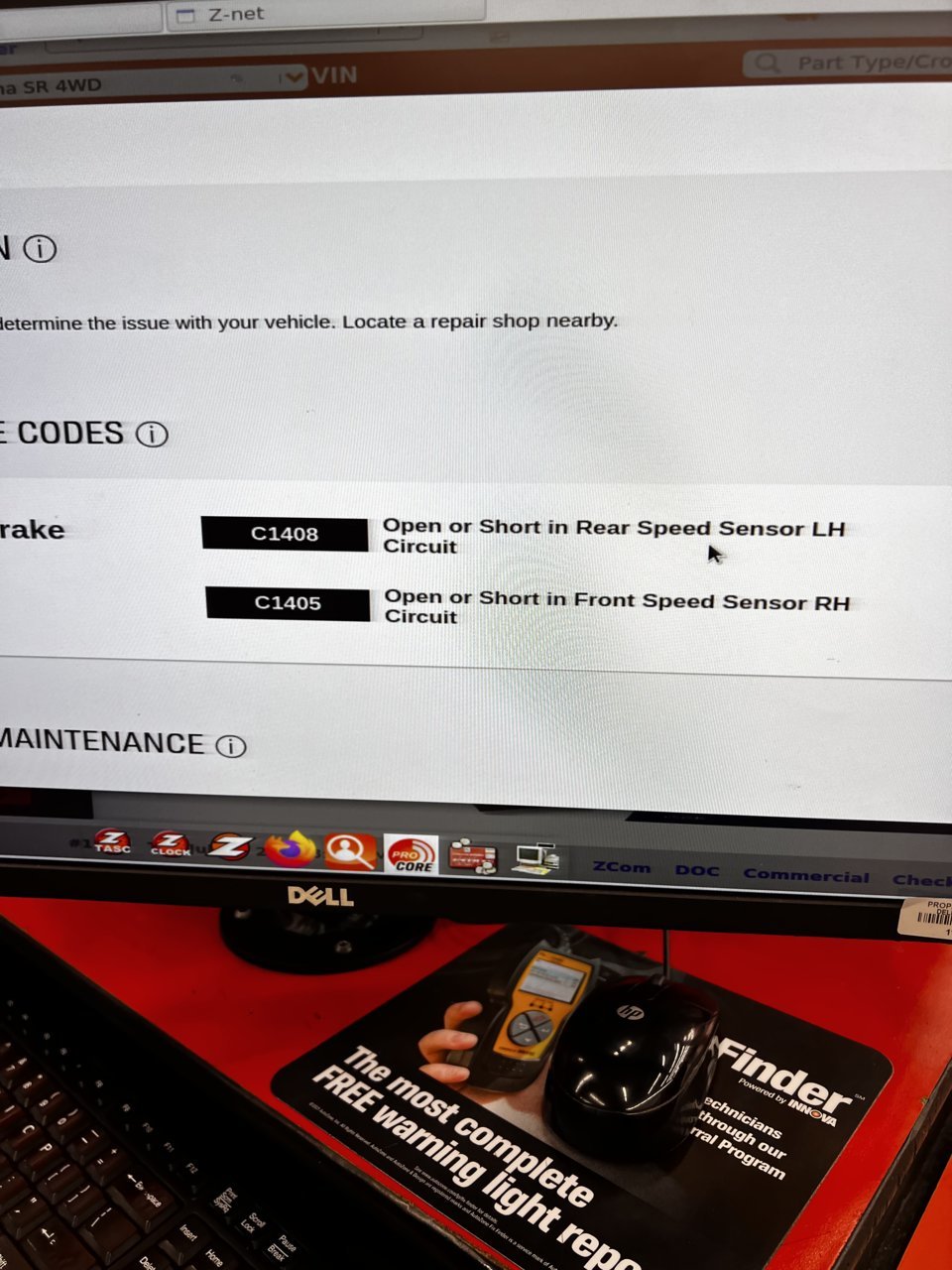

    We’re you able to fix this issue?
    Today while driving home (it was raining) I got the warnings lights.
    Took it to autozone to get it scanned and I got this codes
  8. Jul 8, 2022 at 7:52 PM
