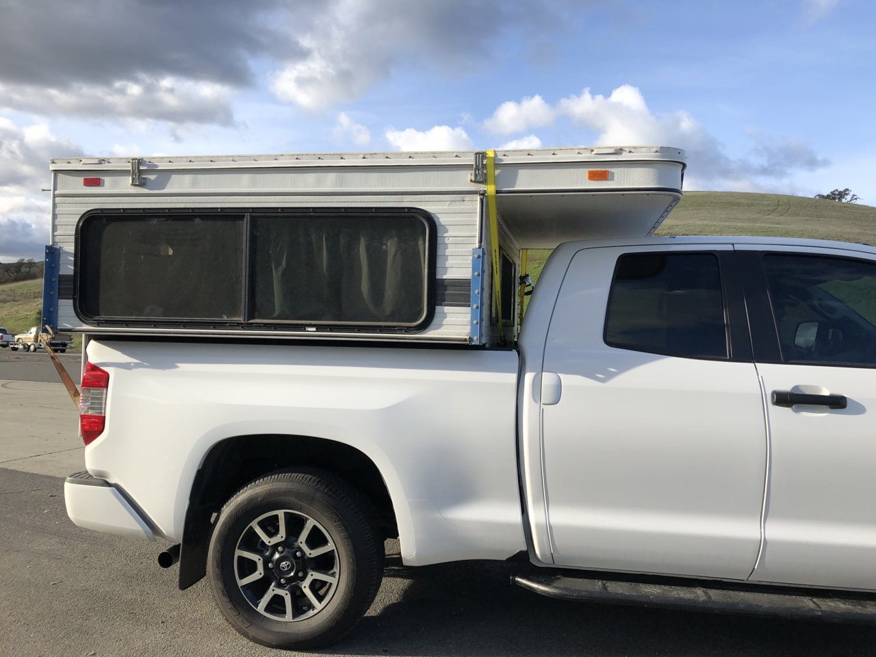

    This is how I got my latest camper home. Screwed to plywood and strapped to my front mounts and rear hitch. 4 hour drive with plenty of passes and didnt budge.

    I did the same thing with nylon ratcheting straps when I bought my camper. It was a scary white knuckle ride driving home! The camper was making the truck rock like a boat in choppy waters due to the winds on the highway. The plastic bed liner made the camper shift it's weight around. The stock leaf springs were sagging. The 15" wheels with 225/65/15 tires rated for C load couldn't handle the load. I did every newbie mistake of what not to do and I was surprised that I didn't drop it in the street or highway.

    Yeah I had already installed airbags cause I use this truck mainly for towing. And yes if you have a plastic bedliner you need to get a rubber mat to keep the sliding down.

    Its a 99 FWC with a rotten floor pack. I did a full rebuild. Got it for a grand.

    I have the daystar cradles and love them. I have the factory bedliner and the plywood camper base sticks good to it, but with the mat it all sticks together even better. I check my turnbuckles every month and they havent budged, whereas on WTW people have to tighten theres pretty often until they pull their plastic bedliner and install a mat.
