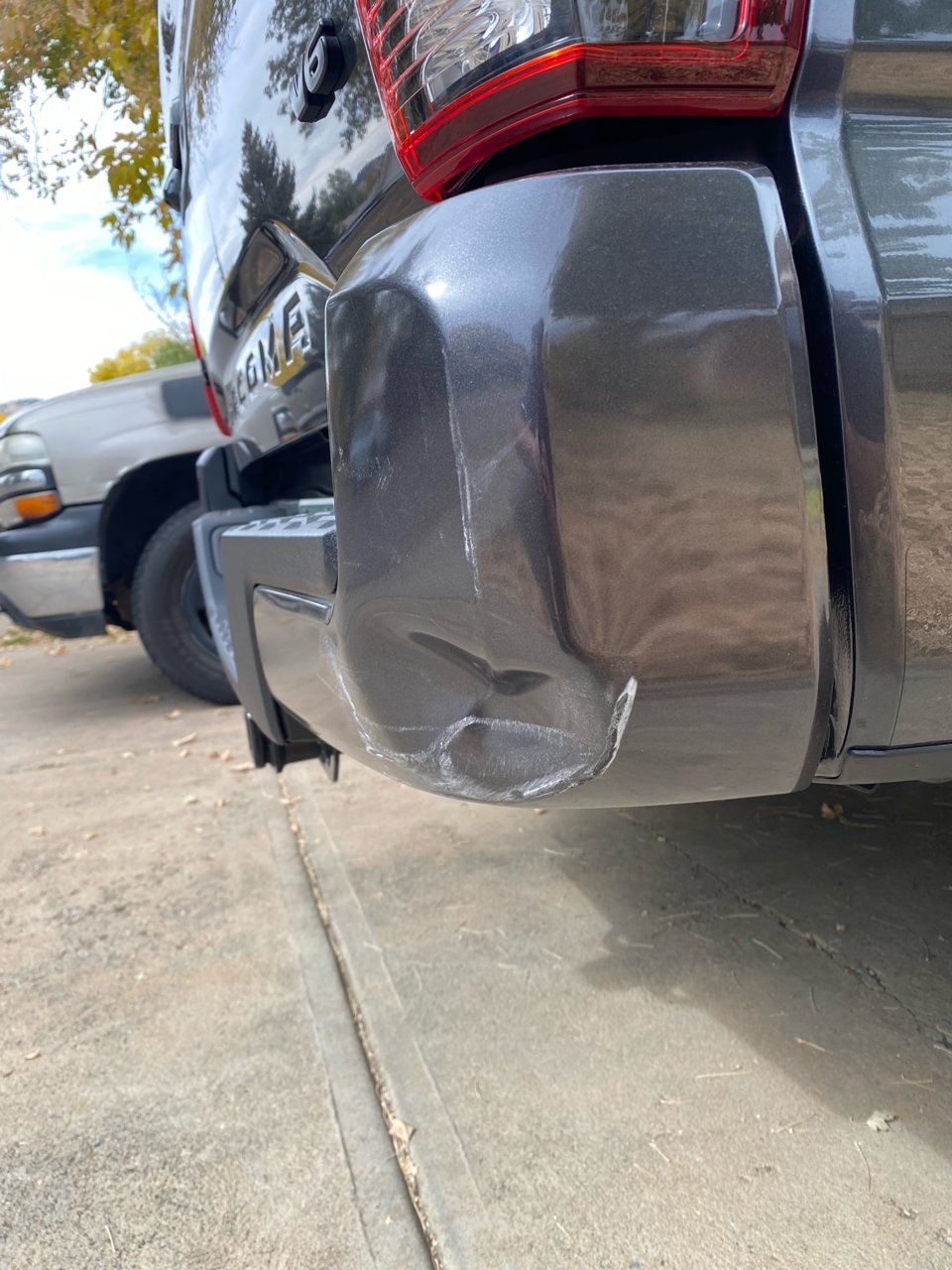

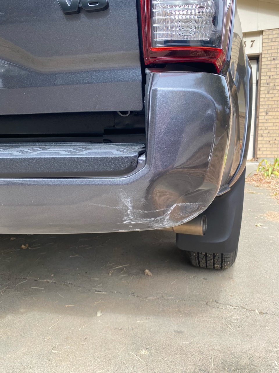

    Someone decided to leave my 6 month old taco with a lovely dent. :burp:
    Is it possible to pop this dent out? Or anyone have any suggestions/tips?
    The bumper material seems very stiff plastic so not sure if its possible.

    My best guess you have to push out from the inside. Heat it up with a paint stripper (gently). Creases will still be there.

    you are not fixing that, and having it look good. the nice thing is, it is a modular bumper and the right end piece is available separately. buy the part, take it to a body shop have it painted, and install it yourself. or take it to the body shop and have them do it all. Ski

    Heat gun and rubbing alcohol will take care of 90% of the damage.

    I would call a paintless dent repair (PDR) and see what they can do. Usually pretty inexpensive and I know they’d be able to pop the dent right out. Not sure about the paint though

    Here you go. Safest and easiest way. Heat guns can damage paint.
    Go to how to fix bumper with boiling water on google for more examples. I am attaching one cause I find it funny. After that rubbing compound to get the scratches out, then polishing compound.. may need a wet sand and buff or paint if scratched real bad.
    https://youtu.be/K32ks6JTRmc
    Edit, there is a metal bracket under there I think, you can bend that back

    Thanks all, I'm gonna try the heat/hot water method to see if I can at least get it looking better, and buffing it as best as i can. If I don't like the results, I'll look into replacing the whole piece or a cap over it.

    Update: I fixed her up! Boiling water worked great, able to pop off some screws underneath to get around the back side easily. Buffed it out with some Miguires Ultimate Compound after, applied TW Ceramic coat after to protect it longer. Its not perfect , some of the creases arent in the correct spots but overall its barely noticeable! I'm happy. Just one deep scratch that its gonna stay there (last pic).
