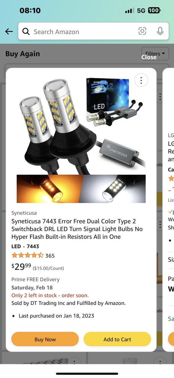

    So far…. Added fog lights swapped halogens to led’s, interior lights to led’s, bed lights added, led/strobe brake lights, trying to figure out the right leds for turn signals.
    I purchased bulbs that had a resister after the plug into the factory wiring but before the bulb, and they have worked flawlessly
    Here are the bulbs I got
