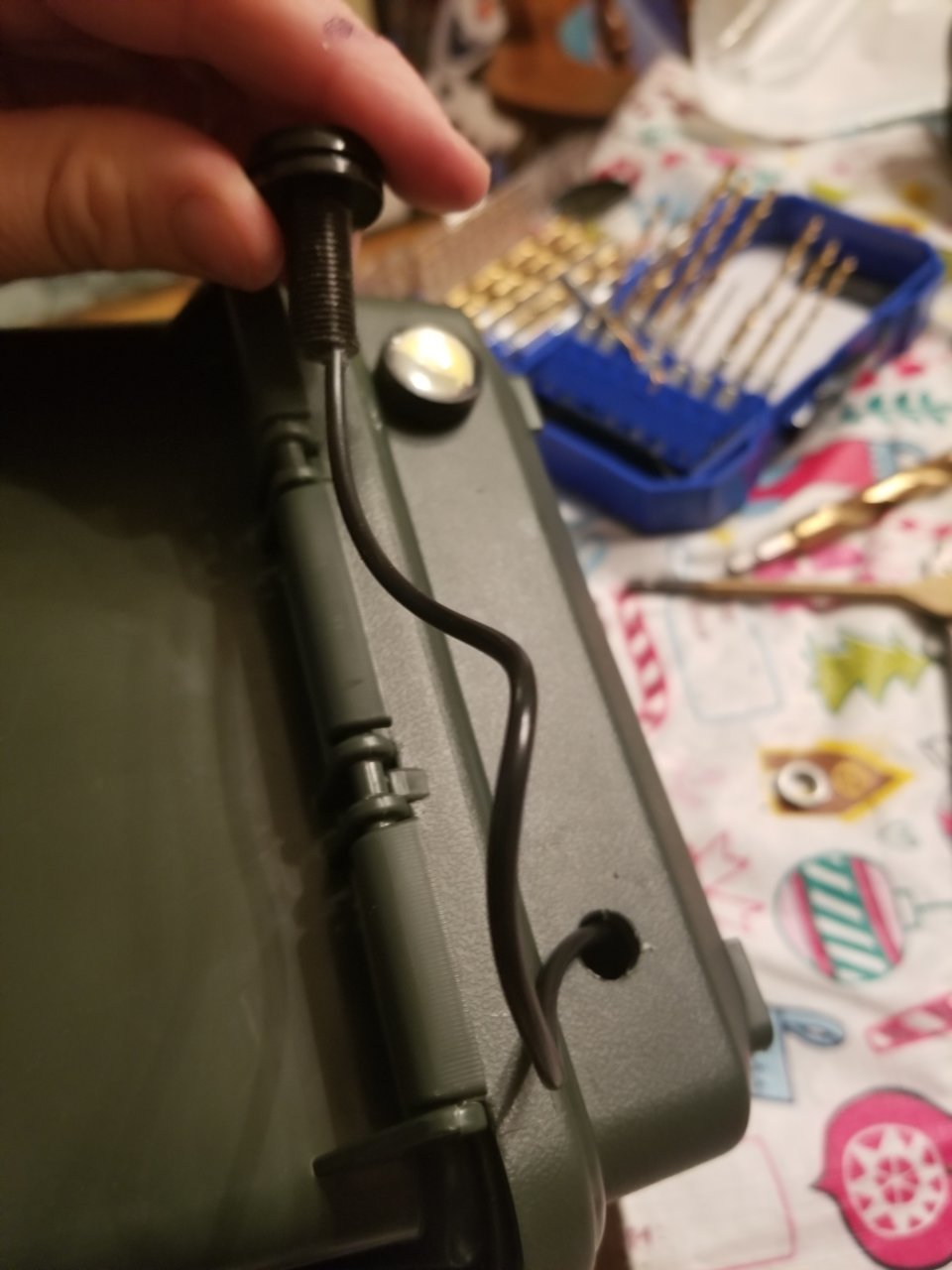

    I got bored and have always thought those power boxes built in ammo boxes were neat.
    I can see how they are very useful when ice fishing, camping, on even just to have for outdoor activities. A couple guys I ice fish with have them, and the couple prefab ones are disappointing imho. I never thought the prebuilt ones that I had seen seem to be:
    1. Worth the price.
    2. Built with flexibility and safety in mind.
    3. Built to maintain the waterproof nature of the base/box.
    Now I know lots of people build these and sell them on fishing sites and outdoor sites, and tend to do a fine job. I decided that since I had a few Dunhams and Tractor Supply giftcards and tons of electrical components; I would build one that would fix some of my biggest concerns.

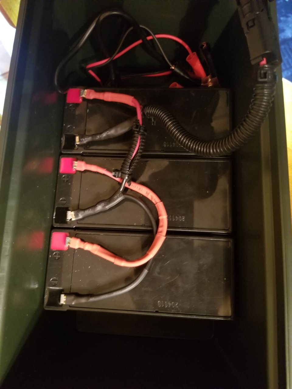

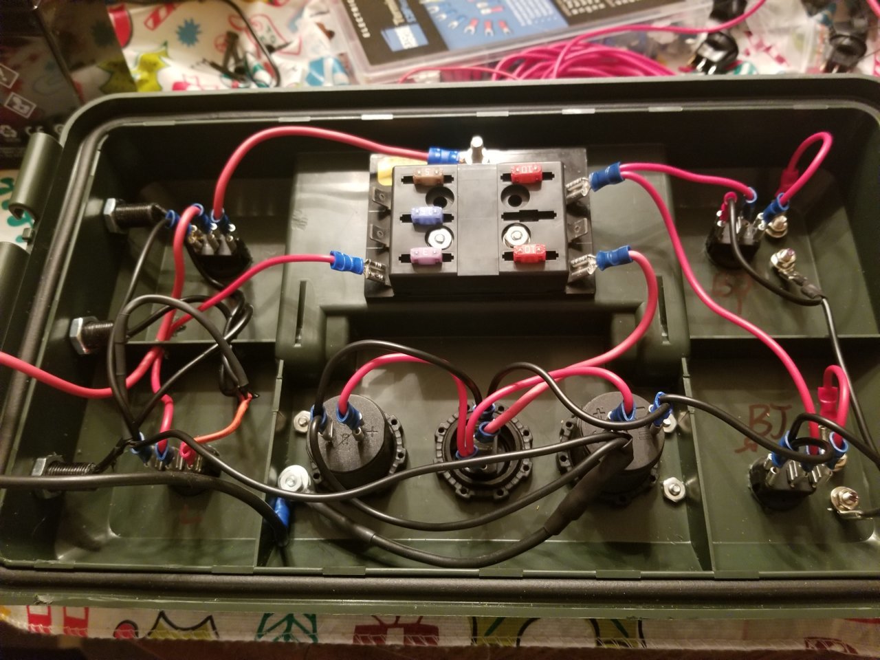

    So if any of you like to tinker, which many of you TW folks do, here is my humble build.

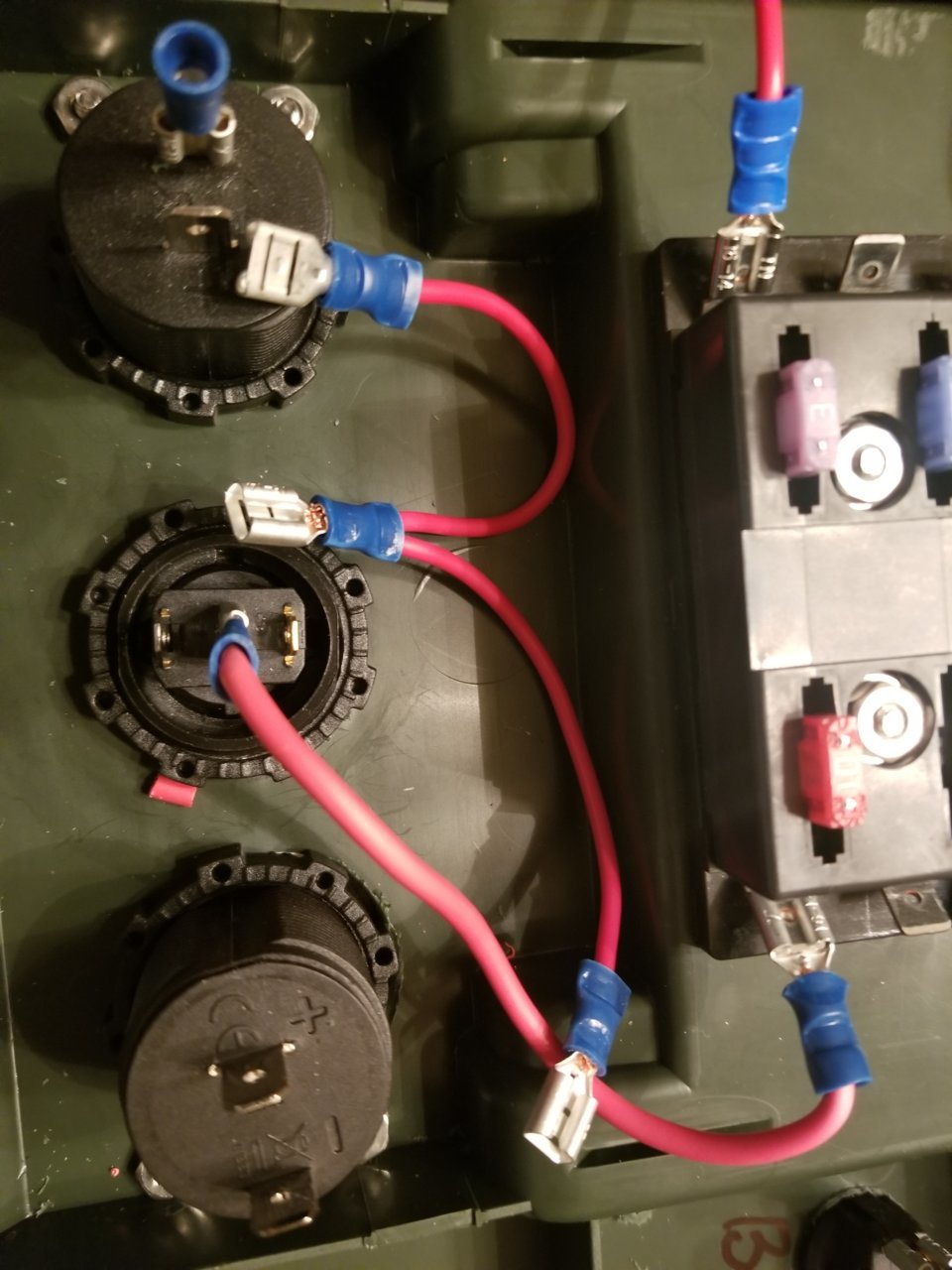

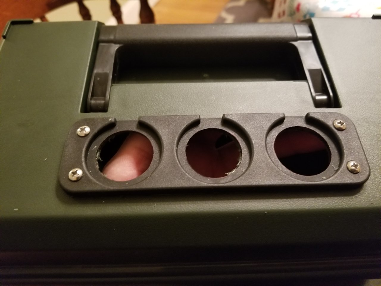

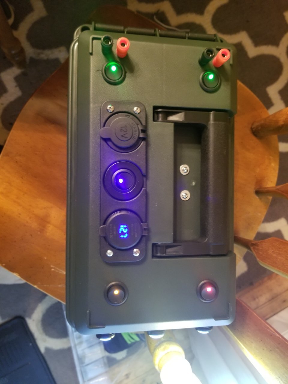

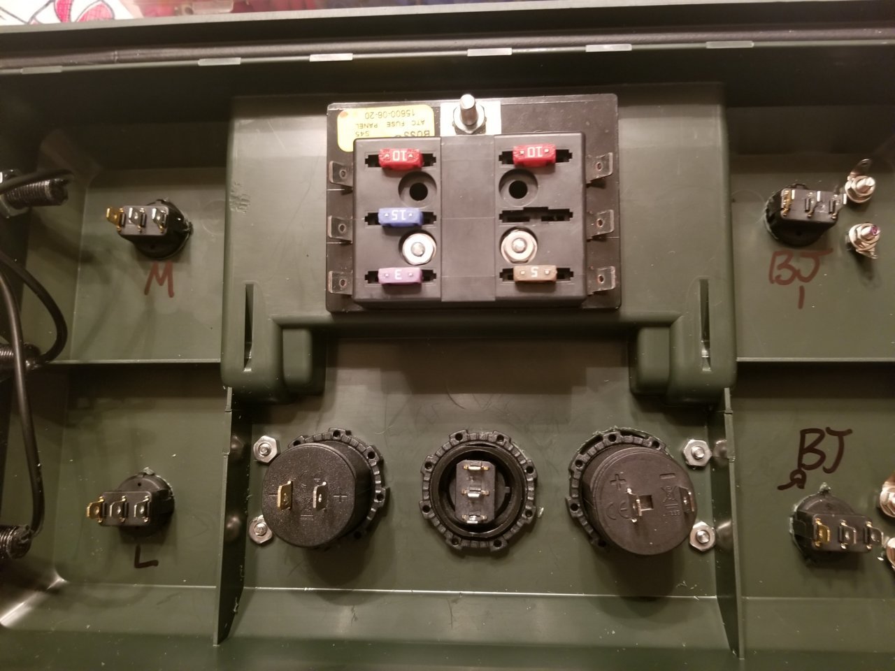

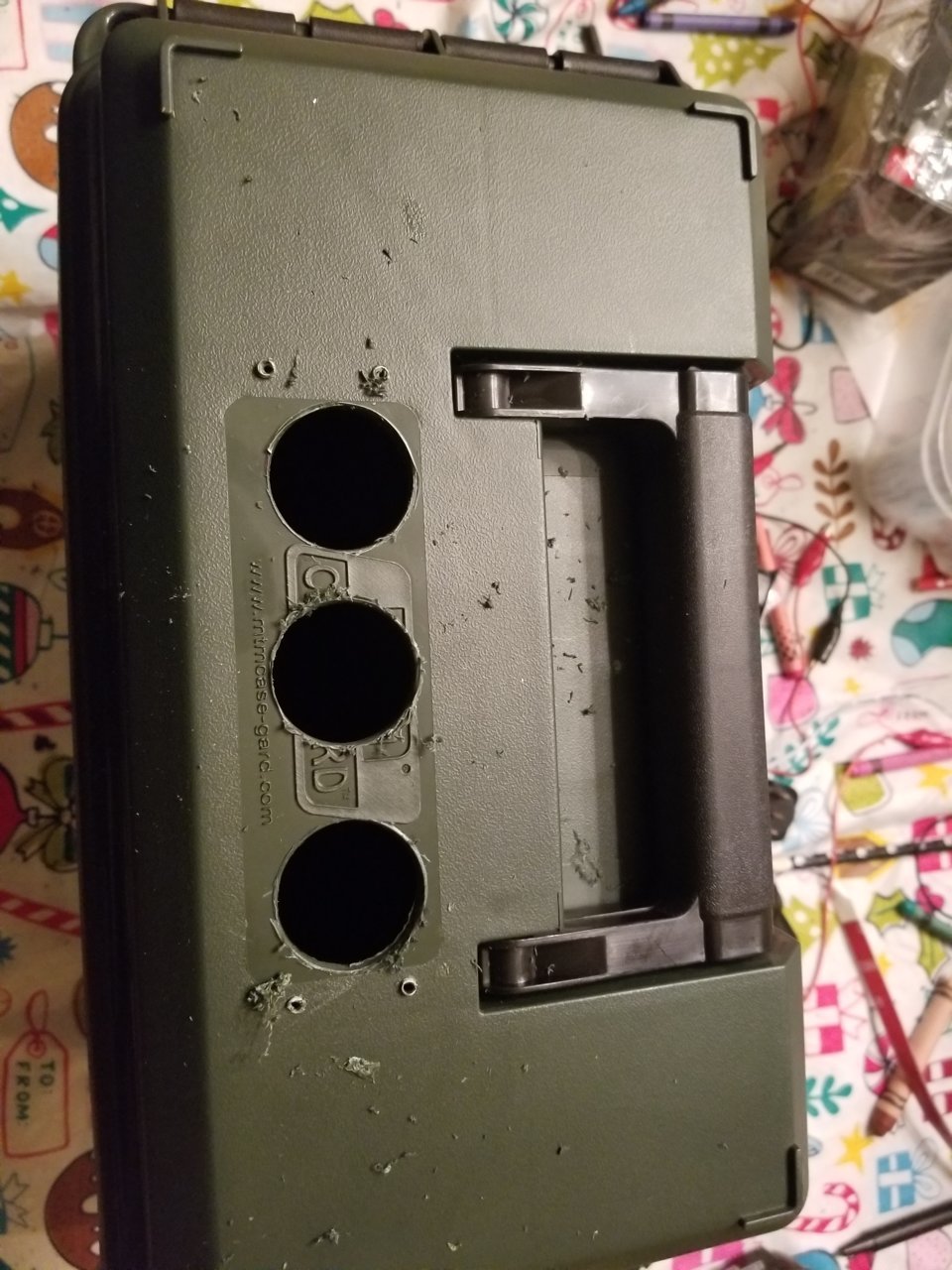

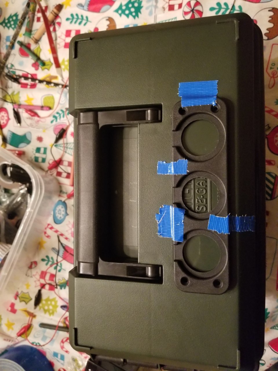

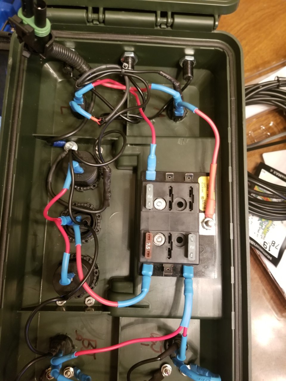

    I wanted to keep the majority of electrical components and all added holes in the lid of the ammo box and to protect the circuits with fuses and switches.
    6 slot fuse panel
    Switched 3 gang 12v panel, dual usb with voltmeter, 12v standard outlet
    Master power switch
    2 banana jack sets, each switch controlled
    3 bright leds switch controlled

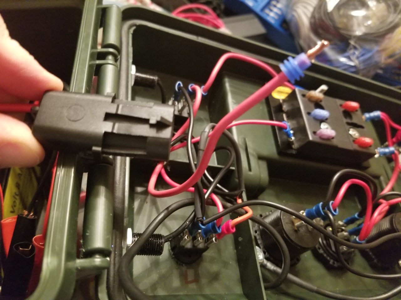

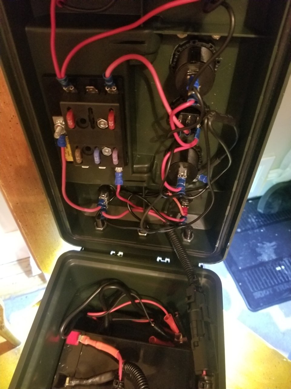

    Metra wire connector to separate battery custom harness from the top panel
    16 and 12 gauge wire used throughout
    Standard case guard 50 cal ammo can
    3 8AH 12v batteries

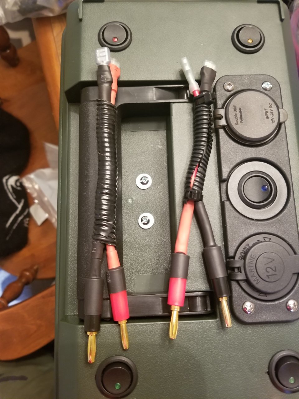

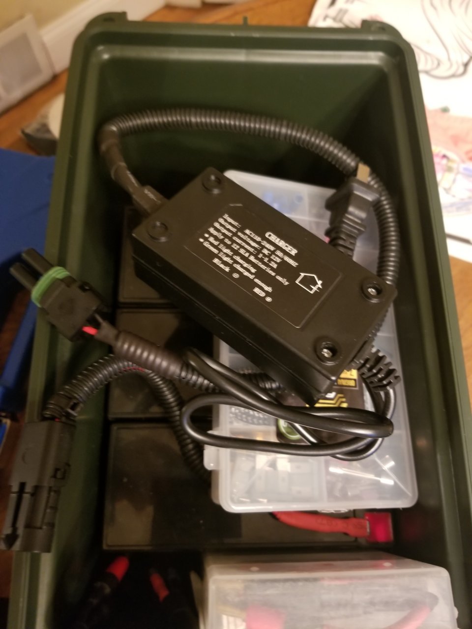

    So I had some thoughts last night.
    1. How to charge the batteries and not arc wires?
    2. What if the accessories, fish finder etc. does not have banana jacks already? (I fish with a few other people)
    Well, I got up this morning and built a quick disconnect charging plug and some universal Jack leads.

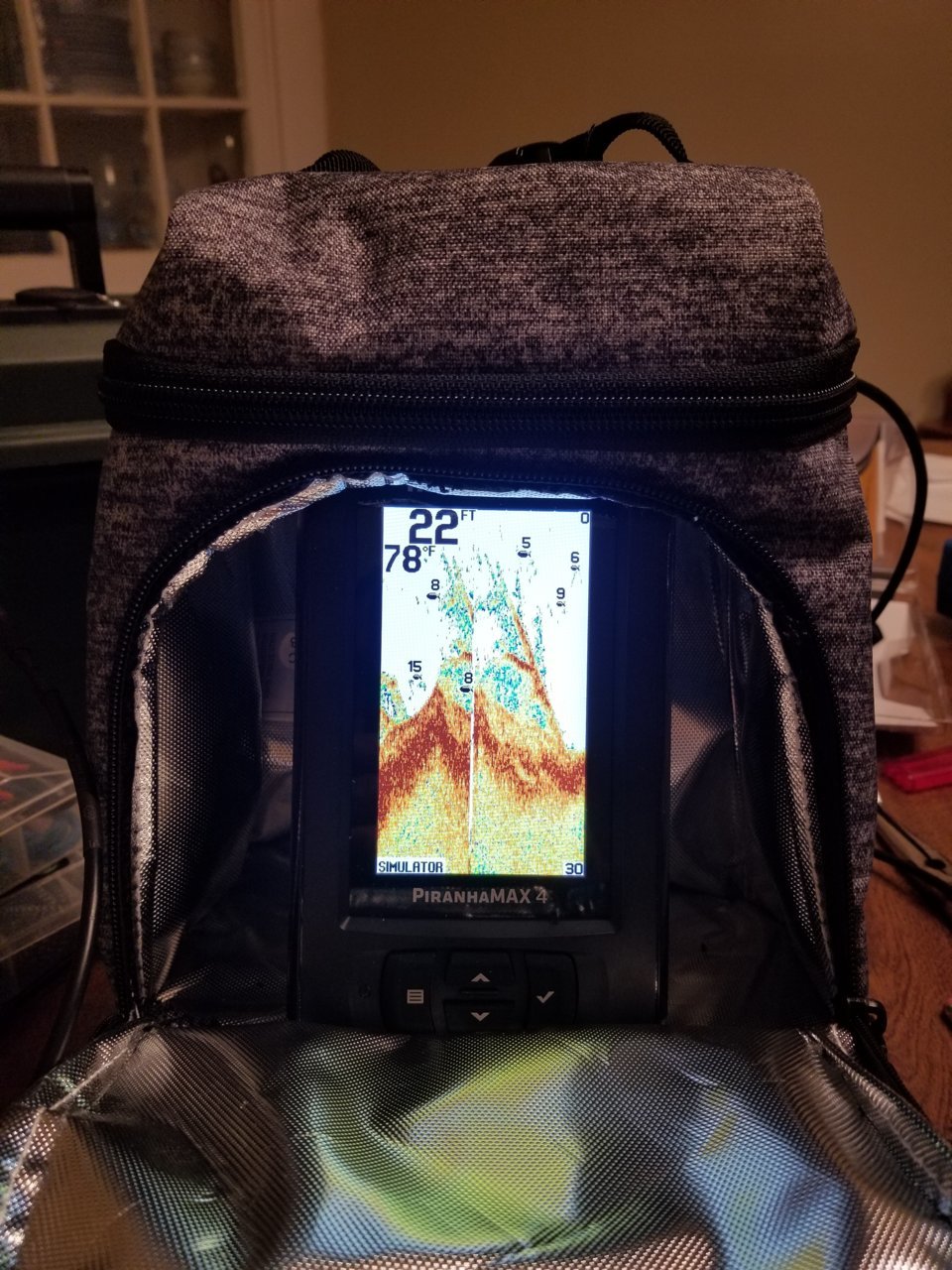

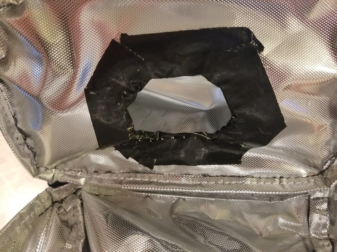

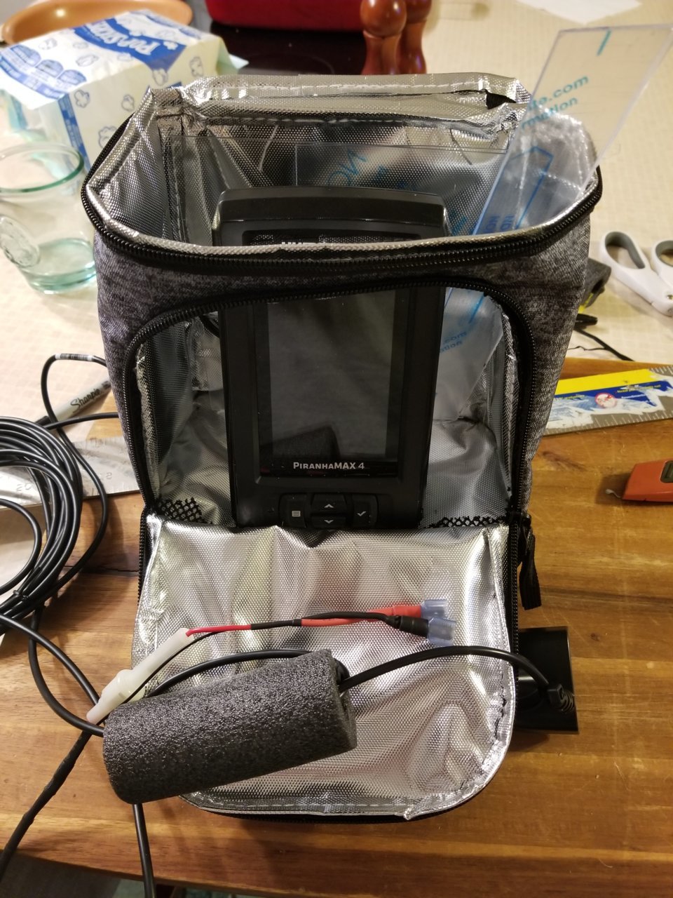

    Cleaned up the wiring and the charger, and then built a fish finder into a portable ice fishing one.

    Hot glue the blue switch into the mount if you want to stop it from rattling around and popping out when the slightest pressure is placed on it. This is mine for my kayak, I have a 3 gang switch, and a 2 gang with volt meter and usb plugs.
