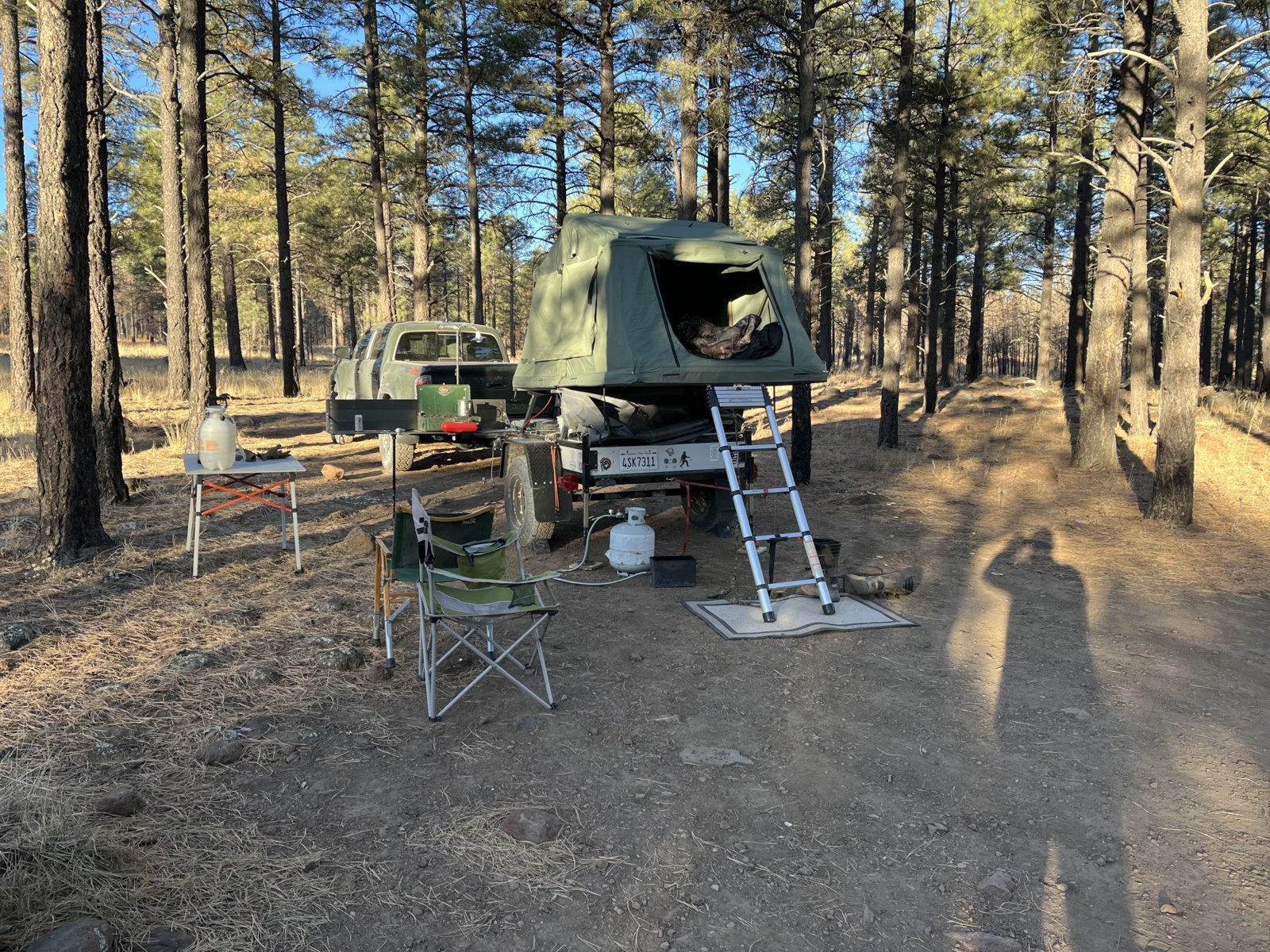

    Here’s my camping trailer I built from scratch. It basically started out as a box with a tent ontop and has evolved over the years. Two things I highly suggest: telescoping/removable tongue helps with maneuvering, security/storage. Trailer jacks on the back two corners to level out the trailer during camp.

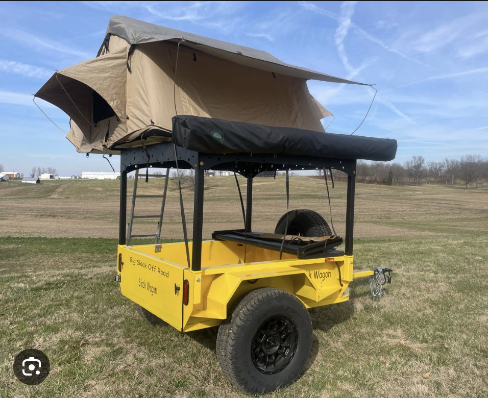

    Here is my homebuilt that serves multiple duties as an RTT platform and a kayak carrier/utility trailer.
    The rack mounts are the platform mounts for a bed rack that I had. For RTT mounting bars, I just used a couple of bars of 1x2 rectangular steel tubing.
    When the tent is off, I mount the regular sides and now it is tall enough to put 2 kayaks in the middle and 2 on the top for easy transport of everybody's boat.
    If I really wanted/needed to experience the high life again, I could still mount the RTT on top of the bed rack as well
    I bought a 4x6 trailer off CL for $100 and modded it to do what I needed.
    It's still a work in progress. Right now the top of the trailer is open but I'm thinking about closing it off and adding access doors in front of the wheels.
    For the RTT, keep it low if possible. The only real downside I can think of from a low mount are awning options, which aren't an issue for us since we use one of the portable canopies.
    Aside from the obvious stability benefits, low will make ingress/egress much easier and your wife will greatly appreciate it.
    I've had my tent mounted on top of a fullsize SUV where it was 7 feet off the ground and I didn't dig it. My wife flat out hated it.

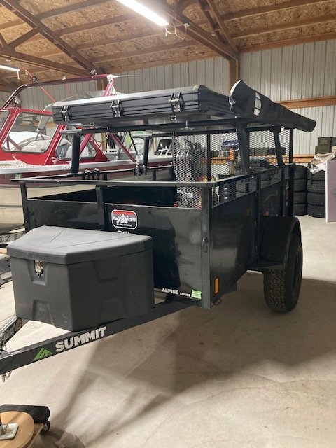

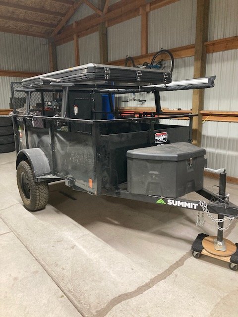

    I did something similar, starting with a Summit 5x8 utility trailer made here in the PNW. It was just over $2k for the trailer alone, but worth the extra money for the build quality. I then installed a rack from Amazon, threw on the tent, awning, tongue box, spring over lift, wheels and tires, and it's been great. I can fill the box with gear, an ATV or dirtbikes/mtn. bikes.
