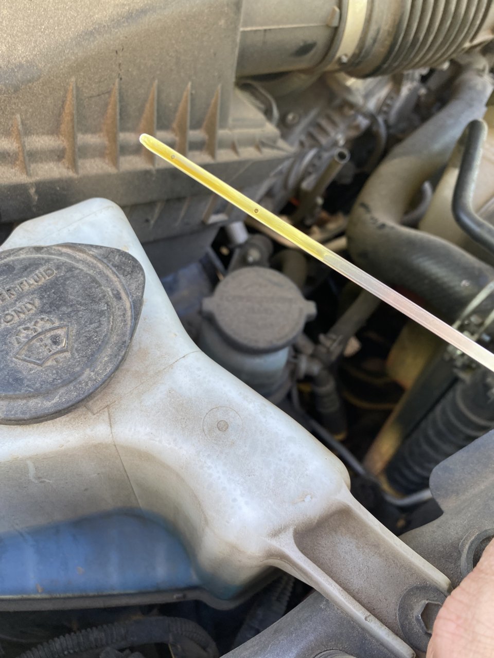

    I had my truck serviced at the dealership at 157000 per the Toyota maintenance schedule request, the dealership here in Glenwood has done 90% of my trucks maintenance with the other 10% being oil changes done elsewhere when they couldn’t squeeze me in. Had a OTT tune put on the truck about 3 weeks prior to the Service being done. After the service i drove the truck around locally for approximately a month, all short trips not more than 50-80 miles total. Had to take a trip to Artesia New Mexico…. 1200 miles round trip. In the 900th mile of my trip at approximately 161700 miles on the trucks odometer I pulled out to make a pass on the 2 lane highway I was on, slightly up hill, wide banking Right hand corner, hit the gas and passed the 2 trucks I needed to pass. I was in sport mode 6th gear & approx. 75-80mph, the truck had down shifted and was at about 3500-4000rmps. As I signaled back into the lane and let off the gas there was an instant loss of power followed by extremely loud knocking from the engine bay & the dashboard lit up with low oil pressure warning & check engine lights. Got my truck towed back to the dealership in Glenwood Springs
    And find out that it is minimum 1 quart overfull on oil, no coolant and nothing in the oil other than than extra oil & subsequent metal shavings from the engine shitting the bed.
    Toyota maintenance department confirmed that it had too much oil in it but said that “wouldn’t matter with this motor and wouldn’t make the truck fail as it did” Subsequentlywashing their hands of the problem and sticking me with a 13000$ replacement that has the potential (in my opinion) to do the same exact thing.

    Does your oil smell like fuel at all or anything? i've seen high pressure fuel pumps croak and the excess fuel get pressure fed into the crankcase and dilute the oil along with "overfilling" it

    If they said it was overfilled but "that's not what broke it, now bend over for the cost of a new engine" I'd talk to a lawyer. Also call Toyota corporate. This is going to cost literally 2/3rds what your truck is worth and overfilling an engine with oil will absolutely blow it up. Seen it several times in several different vehicles.

    They know damn well what can happen with the oil overfilled. The crankshaft beats some of it to a froth, the oil pump takes a nice gulp of it, and bye bye bearings.

    No, not in the slightest. Smells normal and has the same viscosity as regular oil. It doesn’t feel diluted & doesn’t smell funny but I suppose only true way to tell is get it tested.
    Problem being is that the dealership already drained all the oil out of it to confirm that it was overfilled, Then has the audacity to say “oh yeah we overfilled it but that’s not going to blow up your motor, it’s your problem now….. but we’d be more than happy to install a new engine in it for you”

    they drain the oil and measured how much oil they removed, there was a quart extra.
