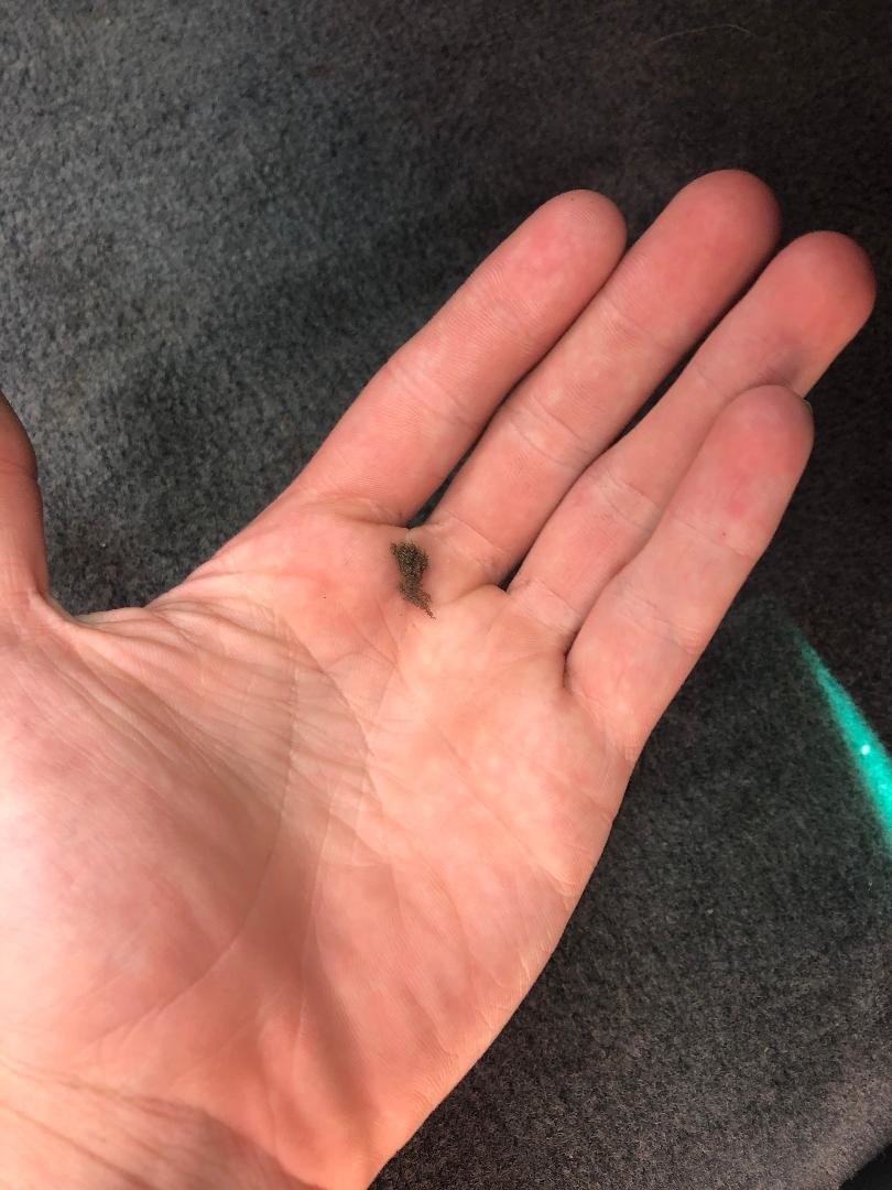

    I started me truck today and turned in the AC like any other day and what I though was dust started to blown out of the vents. I I thought I might have a dirty cabin filter, but then I noticed what looked like brown songy material blowing out of my vents on of the the top dash. Any idea what this is? I have since learned my 1st gen Tacoma doesn't have a cabin filter.

    I had that happen a long time ago on another truck, turned out to be the foam seal/gasket used to connect the plastic ducting.

    They used foam tape during factory assembly to seal the joints on the ductwork. After +/- 20 years, that foam deteriorates and delaminates from the adhesive tape, eventually getting pulled into the ductwork via vacuum and ultimately out of the dash vents onto your seats and center console.

    Its foam duct seal. Mine blows a chunk every now and then. Even if you could get a cabin filter in there, it wouldnt prevent this from coming out.

    Thank you, everyone, for the quick responses. I will attach a picture of what I have. Additionally, I will check the intake and vacuum my truck out now. Haha.
