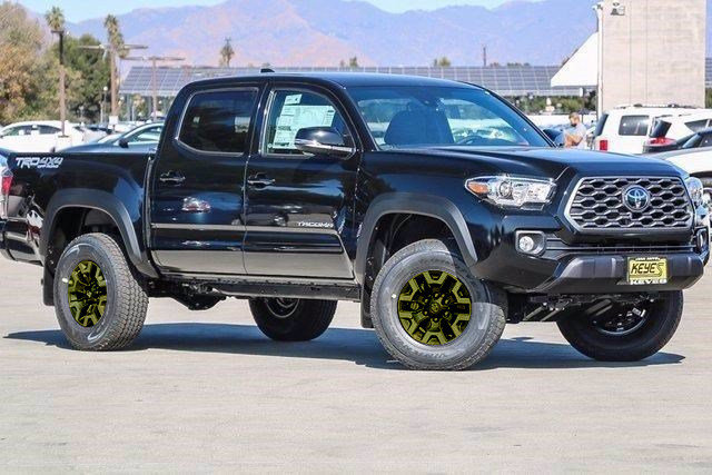

    You haven't found anything because it would look like ass

    That's the point lol I wanna make that judgement myself by seeing if anyone else has done it. They look pretty good blacked out and that might be the route I take if indeed they look like ass when painted gold/bronze.
    **Edit
    I just saw your MS paint picture haha That's a terrible paint job.

    I tried my best :rofl:
    Good luck though, I'm sure someone's done it. If not, we'll let you be the first.:hattip:
