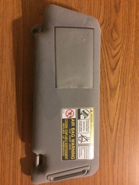

    I'm sure there is a thread already started regarding this, but wanted to share this in hopes if helps someone else out there! Here's my journey to buying a "new" sun visor:
    My driver side visor started out drooping about 1" (which isn't the end of the world, but I'm a perfectionist and it bothered me. It also developed a loud "pop" sound when putting it back against the roof). After awhile it only got worse, in addition to left side getting internally pried open.
    I took it off in hopes of opening it and trying to fix something inside. Looks like the small plastic pronged piece was melted/broken, which I'm guessing is supposed to stay in place to prevent the two metal pieces from turning up (which they were, and I'm assuming that's where the noise was coming from).
    Instead of trying to see if Toyota sells that tiny part, I called my local junk yard for a while visor (just in case) to see if they had my model (they didn't) but the lady I spoke with gave me a company called LKQ's number, which I called and found out they have a shop in my city. They ordered me a preowned one, and $40 later, I can see when it's sunny out again. Aside from VERY minor blemishes (which I was able to get most out), it was good as new.:woot:
    Check them out: http://www.lkqcorp.com/en-us/ :thumbsup:
    *BTW- I called my local dealership first and they wanted $286 dollars for a new visor, no thanks!
    my "new" visor (ignore the dark gray areas, it's wet from cleaning)
    My favorite!
