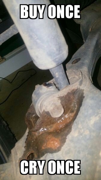

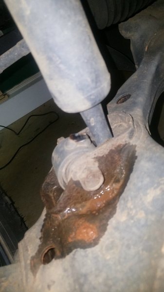

    I was driving down a bumpy road and hear a loud bang. I got out and the truck is sagging towards the drivers side front tire. I look under and see this on the shock! Has anyone ever had this happen to them too?

    Is the front lifted with a top plate spacer?

    yeah it is, feel like this might be my fault for going the cheap route.

    3" lift spacers and no bump stop spacers=kaboom :boom:

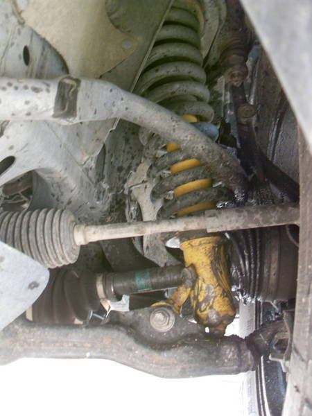

    Yep, your fault. :) Top plate spacer causes the shock to bottom out before the frame bumpstop. Plenty of past examples:
    Happens to Tundras, too:

    100% caused by the spacer lift.
    Instead of the bumpstop (round rubber piece mounted to your frame) bumping off the lower control arm when you bottom out, the spacer causes the shock to become the piece that bottoms out - and the shock is nowhere near as strong as a piece of rubber mounted to the frame.
