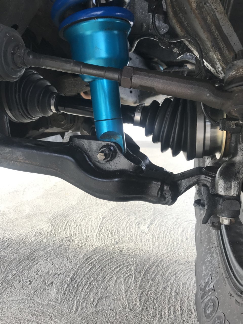

    I daily drive and wheel “hard but responsibly” with the Napa axles & I have a front locker and 35’s for a while (recently upsized to 37’s). Again - what has been said absolutely bashing Napa axles isn’t my experience. Here was a pic from the other day when I replaced one leaky boot Napa for a brand new one (that was free under warranty from them). That axle was on there for a while. Good enough for me but that’s just my experience. Also yes I realize the c clip wasn’t seated correctly. I fixed that prior to install. Also - I don’t buy Napa REMAN, I buy their $120 versions.

    IME - side by side, the NAPA HD wasn’t a sub-OEM quality appearing or feeling unit. It simply wasn’t the case. YES I REALIZE ITS NOT THE SAME and I realize NAPA is lesser quality - but to anyones eye holding the two - it was a bit of a wash.

    Both of those axles side by side are NAPA hd’s. I used a wide angle setting on my camera skewing the photo that’s all
