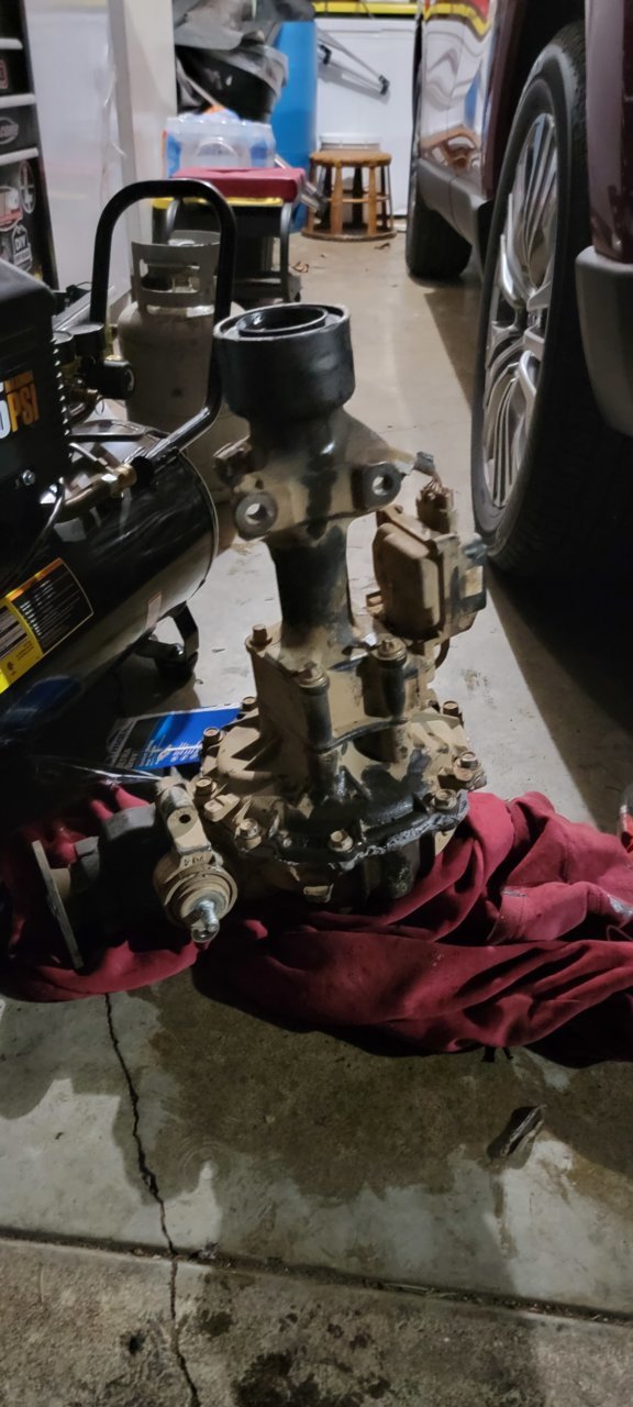

    I broke my front cv axle for the first time out wheeling. Shatter the outer casing and broke the shaft right at the splines. Is it worth the money for the rcv? Ended up having to take my front diff out and open it up to remove the broken shaft.

    Damn, you really did a number on that thing. What happened/what situation was the truck in?
    I cant comment on the RCV axles, but I've done a bunch of moderate wheeling on the NAPA axles and they've held up so far.

    The same shit everyone else has.
    Is that a Toyota axle or aftermarket?

    With rcv axles you will just break your diff instead.

    So probably be better this way breaking cv then breaking diff lol

    Orileys lifetime warranty just gotta bring it back in and get it warranty

    I'm running 37s on 3 inch of lift rear is solid I got dana 60. Regeared to 4.88 locked up rear using a Trac for the front. Front end was over a log but sitting on my skid plate towards the front. Rear tires couldn't get over a log without a little but. So when I bumped it trying to get the rear end over a long front end dip down and caught traction and broke two places

    This right here. The law of diminishing returns impacts these trucks as well. I say replace with an OEM axle, and keep a couple spares on the truck when you go wheeling. I have NEVER seen one broken in this manner. Everyone I have seen is always only broken on the shaft. It is much easier/cheaper to swap an axle than it is to have a destroyed diff.

    Those cheap lifetime parts store axles have way less ability to articulate than OEM axles. I have OEM on the driver's side and parts store CV on the passenger side, when jacked up the drivers side droops 2" lower than the pass side because the cheap CV axle on that side binds up faster.
    On a lifted application while wheeling, that binding will lead to breaking.
    Stick with OEM axles or rebuilt OEM ones (CVJ sells them)

    I have the same limited droop noted above with a NAPA axle. It's my spare when the boot tore and I have the OEM sitting on the bench to reboot and re-install once I find the time. I'd love to hear the story behind the break. Were you locked up front? Bound up? Flying through whoops? crawling?
