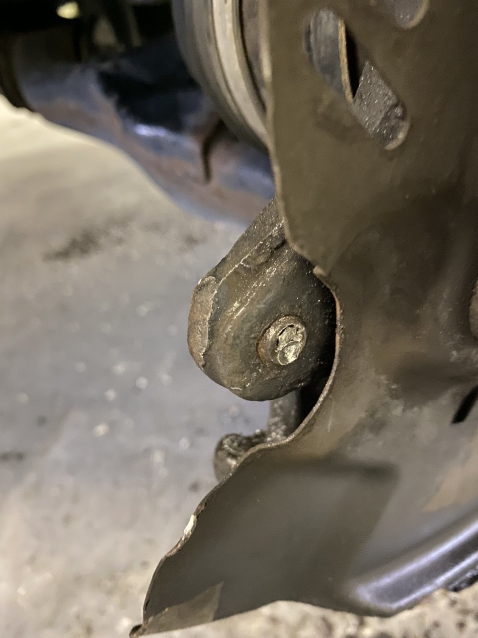

    So i went to do a simple brake job and broke a caliper bolt off. This was the most frustrating aggravating thing i have ever delt with! Took 8 hours to get this out without damaging the threads. Thankfully i had some pretty knowledgeable people to show up and help out!

    >> 2 words. Torque ... Wrench
    2 more words, anti-seize. So it will never happen again.
    Are you in a salted/mag-chloride location? If so, every nut/bolt/faster you remove from here on out should be lathered up with anti-seize on reassembly.

    I am not! But the truck came from PA! So yeah, I’ve already been dealing with that. Even removing the skid plate was a pain in the ass.

    DIY Fabricobbler.
    8 hours? Yikes!
    Weld a nut to the exposed area of the bolt. The shock of the heat will usually release the corrosion by itself, but the nut gives you a way to back it out.
    Regardless, you got it done. Good job!

    We tried that and had no luck. The welder i had there wasn’t the best. Yeah it was a pain and i love doing my own work, but it seems every time something should be easy… something goes wrong lol

    4 something I believe. Trust me, the thought had crossed our minds a few times lol
