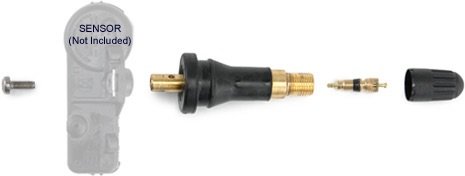

    Some yes you would need a hammer. Most now days have a stem that threads on or gets screwed like the image. I just had new tire put on and watched the tech remove stem and install the new ones.image.jpg

    That's not an OEM sensor.

    I don't think that they do: ( at least the OEM ones do not ).

    Ok, my final post on this subject.
    If you have a rubber valve stem, IT'S NOT FACTORY !!!!
    The op showed a metal TPMS sensor.
    Making confusing posts does not help.
    You have aftermarket sensors. You even quoted that most now days have a stem that threads on.
    His sensor is not MOST. It's factory.
    The first 3 posts should have been the total length of this thread.

    Do not replace that TPMS module, which may require unmounting the tire, rebalancing, and reprogramming at great cost.
    There is a DIY product that will repair that stem inexpensively.
    https://www.amazon.com/dp/B01BM1J9KW
