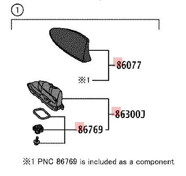

    Here's the only drawing that I could find of the antenna assembly...

    This is correct. It is not that bad. It bolts from underneath. You can drop the headliner to gain access, not remove the entire headliner. Pull the pillar trim, handles and few other pieces and drop the liner enough to get the the bolt.
    86300j is the base that sits on the roof that has the gasket and bolt from underneath. About $200. The 86077 is a plastic appearance cover. It snaps into the base I believe. It comes painted from factory, if the plastic cover is only damages you should still be fine, the gasket seal is below the base. You may be able to snap in the cover, or order an new color coded one to install
