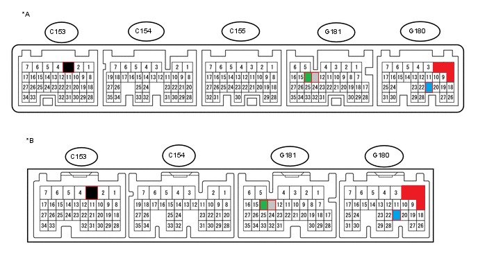

    Nyrob
    Nyrob Well-Known Member
    Mar 4, 2021
    #358202
    785
    Robert
    2021 SX 2.7 AT 4WD
    5100 1.1 Front, 5125 Icon Stage 2 Rear, 5.29's, LCE Header
    Yeah I gave it my best shot there are different ecus with different pinouts this happened to be for mine
    “attached is the pinout. The TOP version is for your ECU. the BLUE and the BLACK pins are ground. The GREEN is CAN LOW, grey is CAN HIGH, and reds are power.
    Connect it like this directly with 12v to the orange flash cable and then use the gen2 force flash again”
    Junkhead, 3GTCMLMTD and Technique like this.

    Nyrob
    Mar 4, 2021
    #358202
    785
    Robert
    2021 SX 2.7 AT 4WD
    Np I double checked all connections were correct verified everything with Matt even about the cable set up I was using with a belkin usb c apater to my Mac running parallels. That is his exact set up for tuning as well. I finally gave in but maybe someone can bring it back. I can’t see why it wouldn’t the voltage was good tune successfully flashed.
